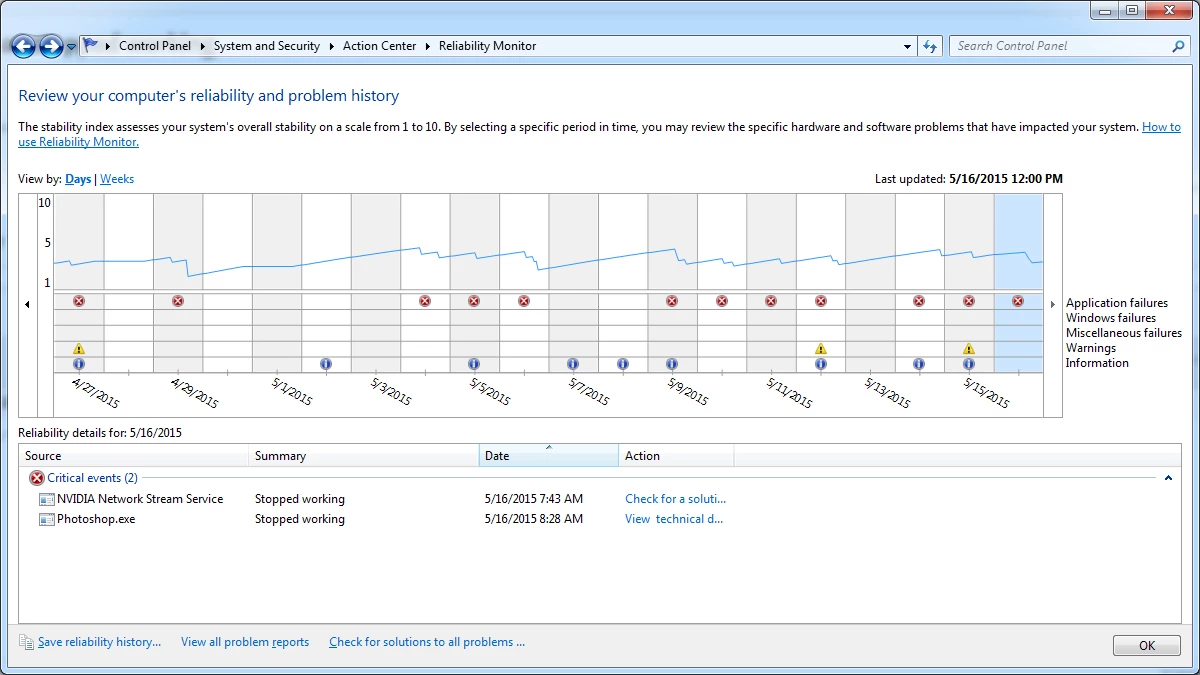

What does the Reliability Monitor have to say about the crash?
