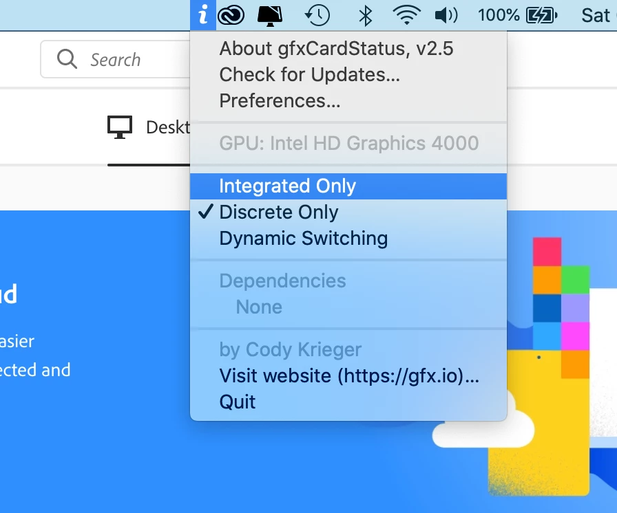

You can try disabling the Intel graphics. Note that the nVidia card is old enough that it may not be supported for graphics acceleration.
April 24, 2021
Hi there, thanks for the suggestion. I downloaded this application called gfxCardStatus, and it lets you disable the cards. I've attached a screenshot, and it basically switches back to Discrete Only everytime I select Integrated Only. It won't let me use the  main nvidia geforce card on its own.
