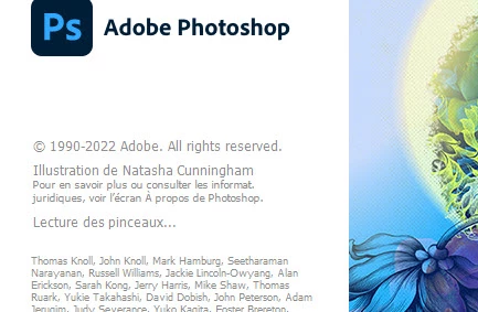

Hello
Yesterday,  I installed the last update for Photoshop
This morning, it does not start and seems to be "stuck" on loading brushes
Could it be a damaged file, a memory problem ... something else ?
How could I "force" the start of fix the problem
Thanks  Have a good day

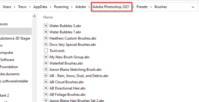

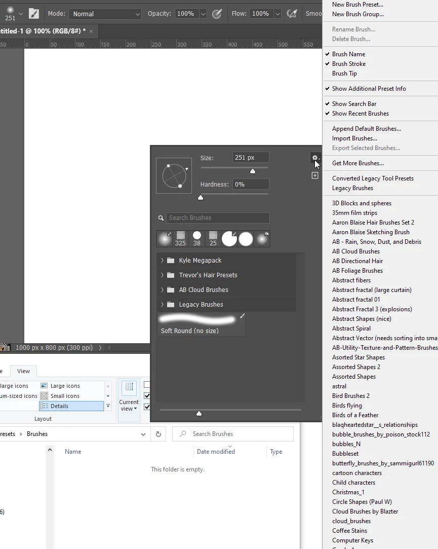

Hmmm... Hold that thought.  As you can see below, the brush presets fold is empty but Photoshop still has all the .abr files.
It might have loaded them from the previous version, which you can see is still there.  Give this a try all the same, and if it does work, then try copying the .abr files fropm the previous version as they will probably be OK.  For goodness sake back it up first by saving it to another folder.
