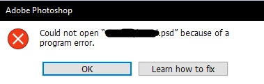

Here's the issue I'm facing: I can't open any file on photoshop if I have graphics card enabled. When I turn it off, I am able to use photoshop (but obviously I still want to use it with graphics card enabled). Sometimes, Photoshop will completely bug out and not let me close it normally, and I am prompted with the pop up that says "Could not complete your request because of a program error". However, I am able to use photoshop if I open a file without graphics card enabled, then I turn on graphics card in my preferences while in a file, exiting the file, then opening up a new one (everything works like normal). But, after a while my photoshop will crash (5-10 minutes).

@Ged_Traynor Hey, sorry for the really late response. Usually it takes me a few days before photoshop starts bugging out again so my responses have been very delayed. So I've updated the AMD GPU and it still doesn't work. I've also replaced the GPU with a new one, and I even tried using a 3060 with my computer but the problem still persists. I can't seem to open any files again. The monitors are connected via HDMI cables. One of the monitors is my main monitor which I use for gaming. It's plugged into the GPU. My other monitor is my Cintiq, and it's plugged into the CPU. I'm still getting the error message.
Generally, photoshop will work for the first few days but after a while, the problem will pop up again. I've tried using other adobe softwares like indesign and I haven't had an issue like this there. I also use programs like ZBrush and Maya, but I don't seem to be having issues on that front as well. The problem seems to be restricted to photoshop only.

Looks like you have dual GPU's on that system and 2 monitors, how are the monitors connected, seems like you have one monitor connected to the onboard GPU, also the driver for the AMD GPU is out of date.
