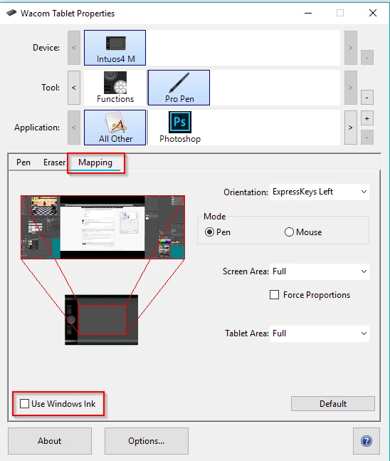

    Hi Falrinth.  This is a known, albeit only occasional, issue, and I don't know why some people are affected but most are not.  If you are currently using the Windows Ink API, try switching to WinTab.  It pretty much always works better with Windows 8.1 and 10.
    Disable Windows Ink in Wacom Preferences
    Create a Text file with Note Pad with this line
    UseSystemStylus 0

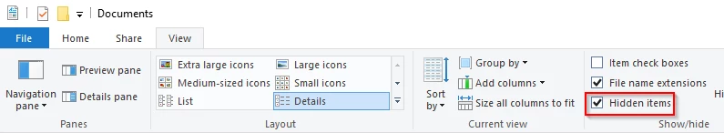

    C:\Users\[Your User Name]\AppData\Roaming\Adobe\Adobe Photoshop CC 2018\Adobe Photoshop CC 2015 Settings\
    Note: we are only three days out  till MAX and the next major Photoshop release, which I expect to go live on the 15th, so you'll need to copy the file to the new location after updating.  Unless already so set, you'll need to make Hidden Files and Folders viewable in File Explorer.
