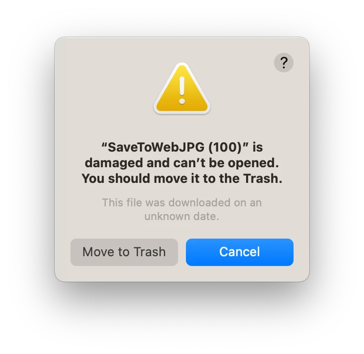

Hi Everybody,
I'm trying to create a basic droplet for Save For Web and it's getting rejected by Finder. I tried making my own and it was damaged (image attached). I then tried using one of the default actions and it just did nothing...?
I'm using OS X Ventura. Anybody have this problem at all?

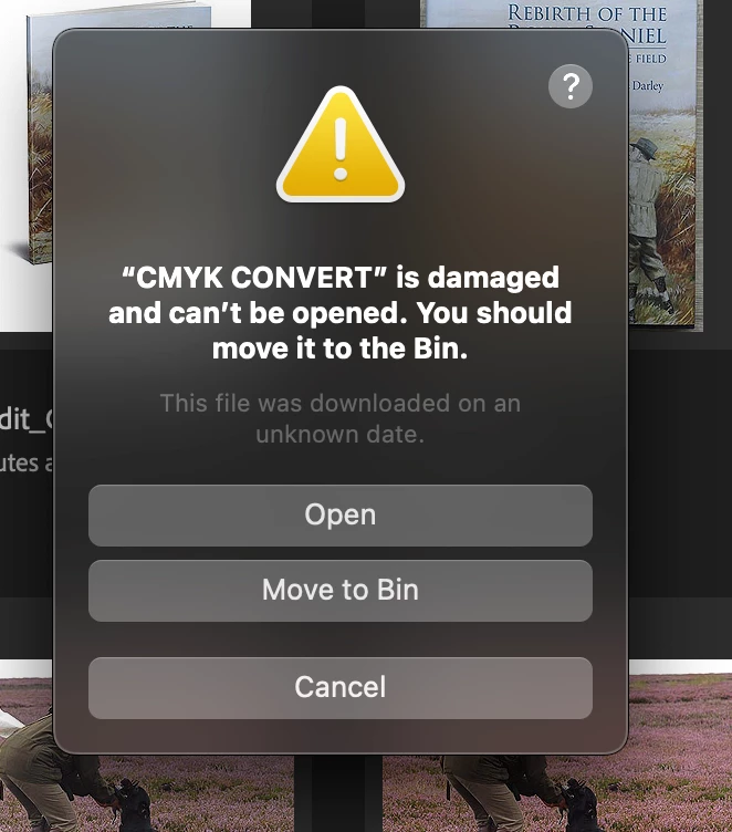

yeah this is ventura. So create the droplet...
Then right click on it to open it. Will say it's damaged.
Then try it again and it will give you a second option to open it with a right click and open.
Open it and it should fix it then and work as normal. This isn't a bug. It's how OSX works now.

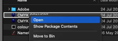

  1. Go to Finder and select your droplet.
  2. Right-click and open.
  3. The error message will come up. Click open.
  4. This will open in the Droplet app (Mac Ventura).
  5. Quit the app and your droplet will now work.

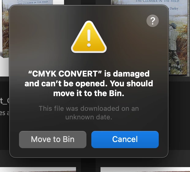

Hi try this
If i control click now to open droplet, first time doesnt work, second attempt to open does, then I press capture then ok and then cancel the process (save then destroys the droplet) then use the droplet it works, this method is working 100%.
