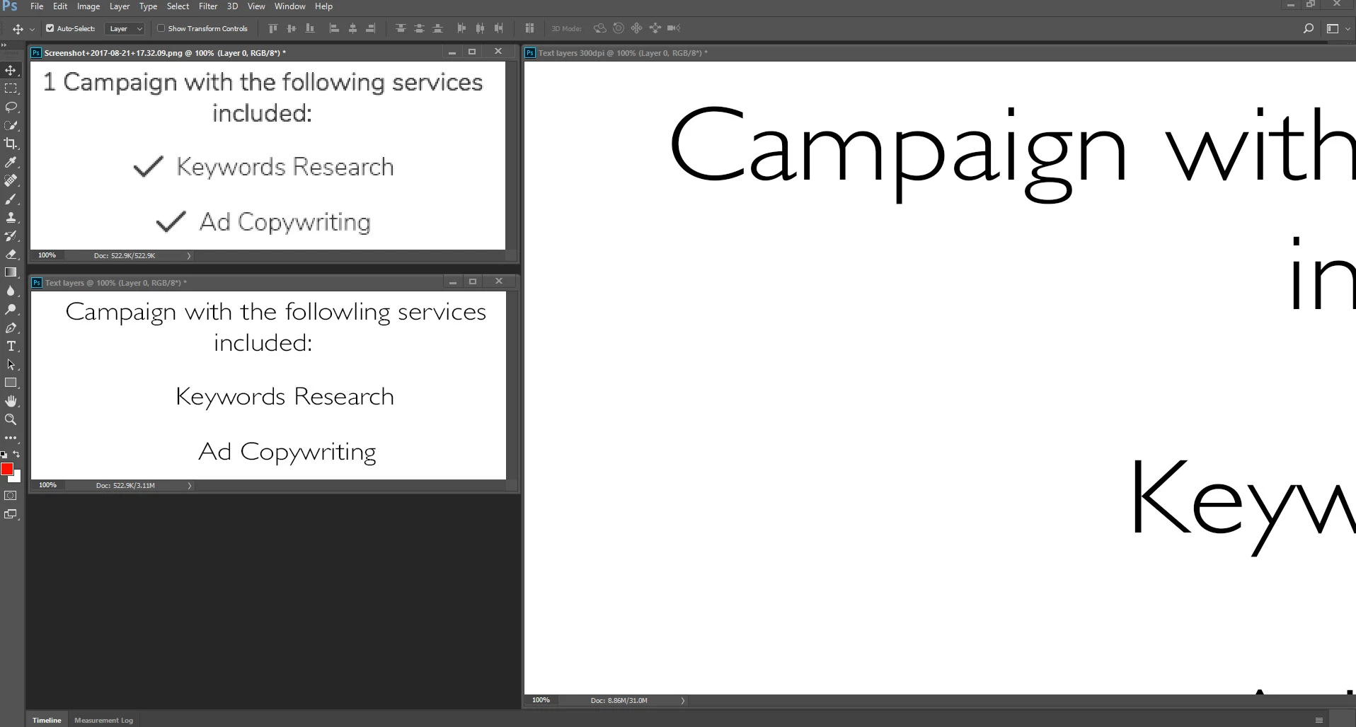

Anyone else has this problem where the font rendering changes, all of a sudden, and while you're working? Here's an image to illustrate the problem:
As you can probably guess, the font family is the same (happens with probably all my fonts, haven't tested ALL, maybe it's file-type related?), as is the weight, size, line-height, everything is the same. I'm also not exactly a newbie with PS and tried a lot of techniques that might affect. The first thing was obviously the anti-aliasing tool. Opening, closing the file, the software, etc.
This happens, mostly, after applying a transformation on the text (cmd+T). After that, i cannot switch back to the same rendering. Doesn't happen consistently, sometimes it happens, sometimes it doesn't.
There is also a side trouble. After transformations, the font size and line-height changes randomly: ex, from 16pt to 16.12pt. This is something that happens all the time and, maybe, it is related to that problem.
Any help or insights on how to solve this would be appreciated.
I'm on a macOS Sierra 10.12.5 and the absolute last version of PS at this time of writing.

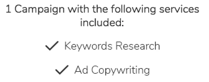

Did you ever find a solution to this? I'm encountering something similar where a font layer from an older file appears much different than a font layer in a new file.
Everything about the following text layer are identical. Same font, color, rendering style. There's no "faux bold" applied or anything else. The only difference is the one on the left was created in a file about 2 months ago and the one on the right is from a new file.
I don't have any solution for this. I just avoid transforming any folder that might contain a text layer with Mac LCD rendering, that's my temporary solution

August 22, 2017
Thanks, JJmack, but it has nothing to do with that, sorry. I need to keep working on 72dpi as I'm developing interfaces for screens.
However, I might have narrowed down the problem. This only happens if:
  • If I'm trying to Transform>Move folders with text blocks inside mixed with other elements (pasted vectors);
  • And if I have anti-aliasing set to Mac or Mac LCD.
It does not happen when I'm using the old anti-aliasing methods. This surely seems like a bug, as this Mac / Mac LCD thing is new... Not sure...
Let me know if you find this problem too. Thanks for the help in advance.

I never use upsized and rasterized text layers, so no problem there. See the video i uploaded; you can see it is showing text layers, not raster layers.
As you can read above, the problem is most likely related with the new anti-aliasing modes: Mac and Mac LCD (talking about CC 2017). But clearly, there's a bug with these new aliasing engines. If the texts are transformed together with other objects, such as Illustrator vectors packed as Smart Objects, the font will re-render into another.
Can someone else replicate this problem in their computers? This way we'd be sure it's a bug.

I'm working at 72dpi, it has nothing to do with resolution. I know the image is pixelated, it's on purpose so you can see the difference.
See the difference from the first two lines compared to the checkmark phrases? The font is thinner due to an unknown bug occurring during the process i've described above. See in video:
