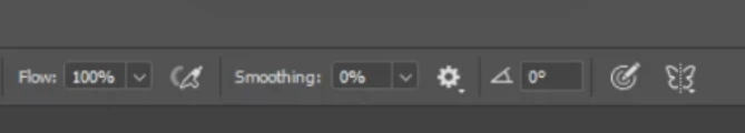

    April 15, 2026
    Hi ​@Mileon17 ,
    Ensure smoothing is enabled.
    Steps:
    1.     Select the Brush Tool (B)
    2.     Look at the top toolbar
    3.     Find Smoothing and inscrease the value.
    Let us know if this helps
    mj

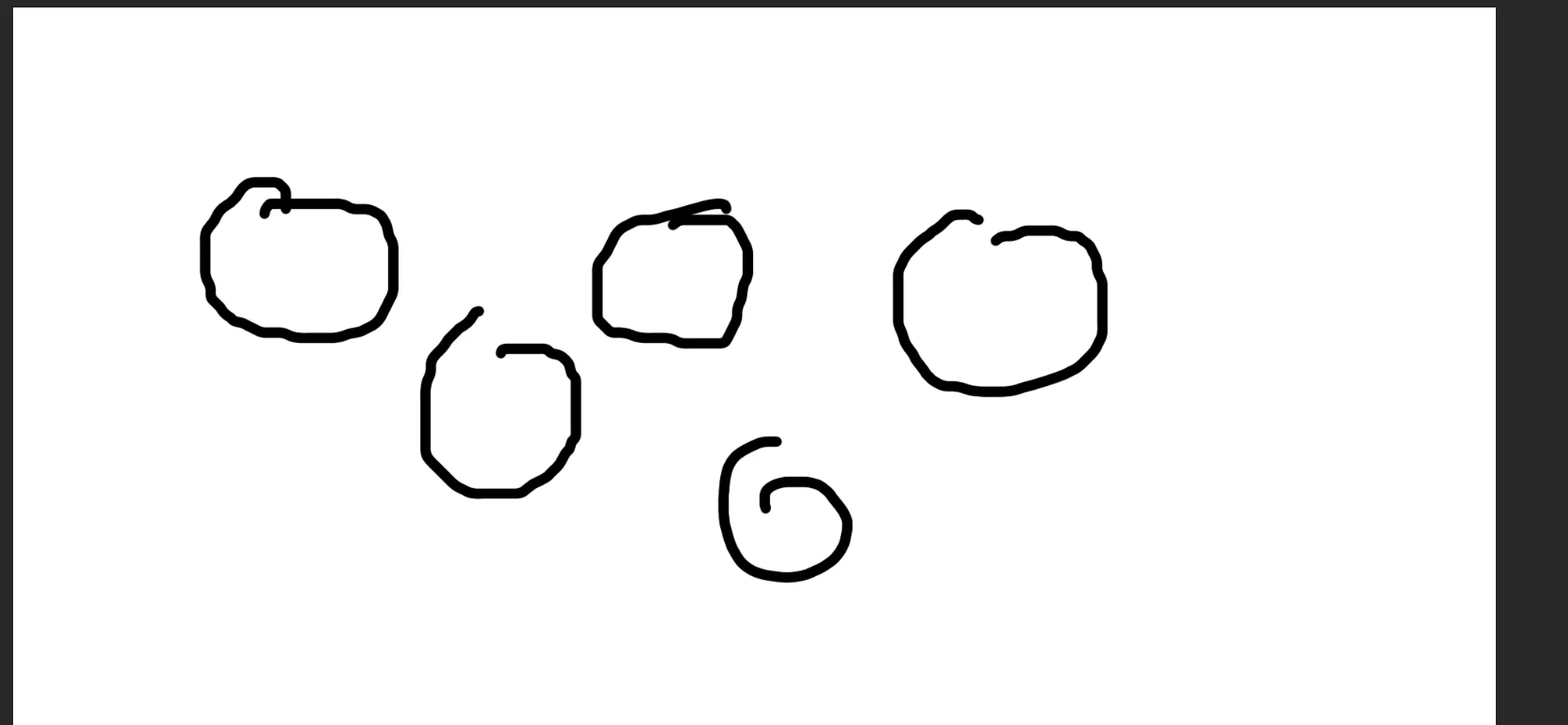

    Mileon17
    April 16, 2026
    Thanks for replying. I think it’s not about the smoothing because the line itself feels choppy no matter how smooth i draw the curve, and the issue still persist after adding smoothing

    Mileon17
    April 16, 2026
    Mileon17
    April 15, 2026
    The app is really laggy and I have a decent pc . but when I draw the line does not feel smooth and the outcome is the curves became jagged and weird they look like lines that tries to look like curves. idk what to do I tried messing around with the performance settings nothing seemed to help this is really unusable
