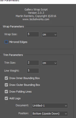

hi, i am after a script for gallery wrap that can produce a black border instead of a white when when you check off the mirrored edges.
have tried to edit a script i have of the original one but not working. any ideas?

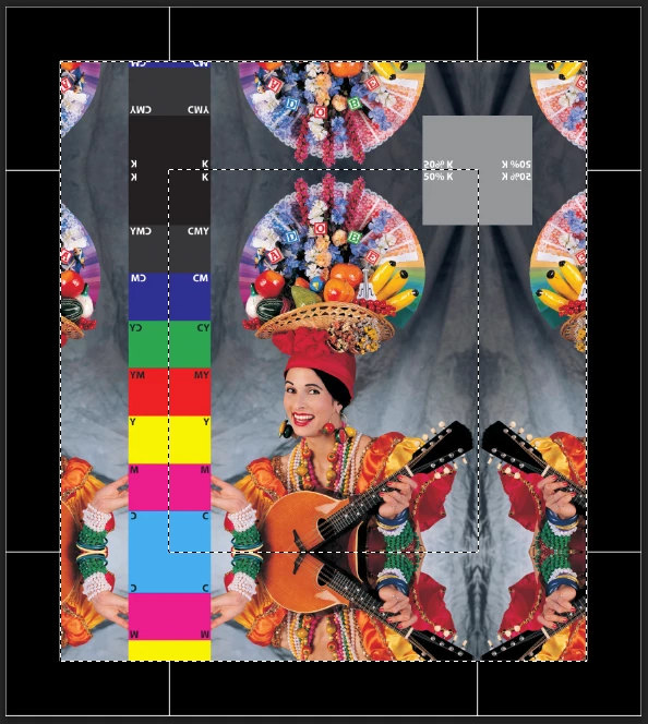

Stephen Marsh
July 15, 2024
@St3ffy22
Apologies, I had an old 1.0.2 version in my archive, so the previous posts won't work.
I'll download the latest 2.0.1 version and post back again.
Edit: Here it is with a black background and reversed trims:

Hi Stephen,
i actually tried this one and it worked. only thing is that i need the trim to be white but the wrap black. let me know if possible.
Stephen Marsh
July 15, 2024
quote
Hi Stephen,
By @St3ffy22
The full edited 2.0.1 code from my previous post results in the following black background and white trim marks:
If this isn't the result that you are after, what needs to be changed in the visual result?
EDIT:
I just re-read your post... Do you mean that you don't want mirrored pixels, just black?
If so, just select "Plain" as the wrap style.
Stephen Marsh
July 15, 2024
@St3ffy22
Unfortunately, DocumentFill.BLACK doesn't exist.
It might also be possible to add an invert step after the doc is created, but I haven't tried...
You can use DocumentFill.BACKGROUNDCOLOR
Changing a copy of the original script from this:
if (docRef.colorProfileType.toString() != ColorProfile.NONE) {
	  copyRef = app.documents.add(w, h, docRef.resolution, "Mirror",
		mode, DocumentFill.WHITE, docRef.pixelAspectRatio,
		docRef.bitsPerChannel, docRef.colorProfileName);
	} else {
		docRef.bitsPerChannel);
To this:
	var s2t = function (s) {
		return app.stringIDToTypeID(s);
	var descriptor = new ActionDescriptor();
	var reference = new ActionReference();
	reference.putProperty(s2t("color"), s2t("colors"));
	descriptor.putReference(s2t("null"), reference);
	executeAction(s2t("reset"), descriptor, DialogModes.NO);
	executeAction(s2t("exchange"), descriptor, DialogModes.NO);
		mode, DocumentFill.BACKGROUNDCOLOR, docRef.pixelAspectRatio,
} else {
Which adds code to reset and exchange the foreground/background colours. An alternative would be to capture the original background colour and then make it black, then reset it back to the captured colour afterwards.
Stephen Marsh
July 15, 2024
Here it is with the invert step:
		     var idInvr = charIDToTypeID( "Invr" ); // Image > Adjustments > Invert
     executeAction( idInvr, undefined, DialogModes.NO );
	} else {
