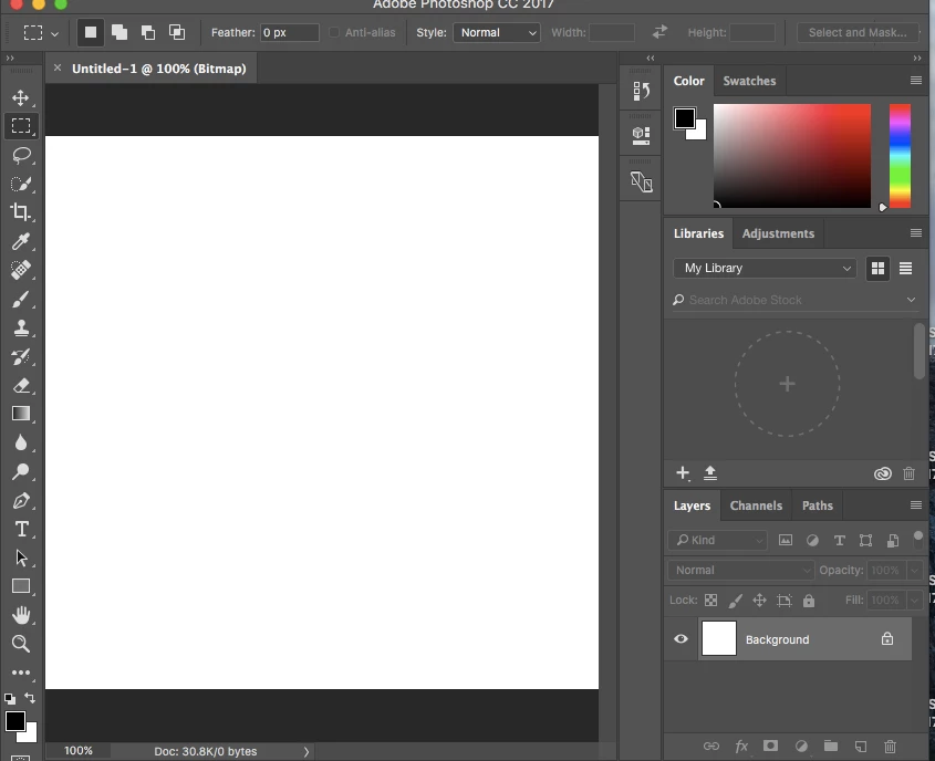

do you know why i can't add a transparency to mine?

Two reasons
1) Mode can not be bit map (see documents tab) You can change it by using the menu Image then Mode. Then choose RGB or cmyk
2) Once mode has been changed, then you need to covert the background layer (in the layers panel) to a normal layer by dragging the padlock to the trashcan.
You will now have a checkboard background representing transparency.
