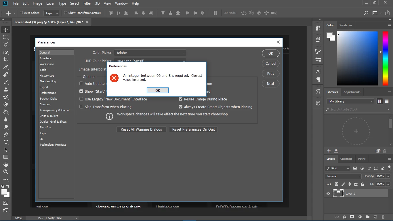

I just realized this today because I haven't use photoshop since I updated into Windows 10 1803 (RS4). Upon launch everything seems fine, then when I open a project and added text, photoshop freezes and crashes without any "crash errors" like the RS4 settings bug. I tried updating and re-installing photoshop but nothing worked. When I launch it back up, it says GPU driver problems so it turned off GPU acceleration, which didn't help at all. When messing around I also noticed that Photoshop is only using up 512MB of RAM max when it usually uses up 1000 - 1500MB of RAM and 2200MB max. And every time I tried any filters, it will say "out of RAM" even though there is still 40% RAM available (4GB). So, I thought it was the Photoshop RAM allocation setting in Preferences > Performance. And somehow only the performance tab was broken (the others like general, export, etc were working fine). Every time I tried clicking that tab this happens:

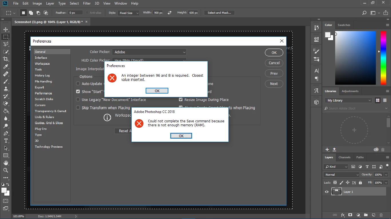

I can't even save that file because this happens every time I hit Ctrl + S:
Every filter doesn't work because of "not enough RAM"

Hi ASEM1123,
Sorry that you're getting not enough memory error in Photoshop after you've installed the Windows 10 1803 version update.
We've identified this as a known issue and our Engineers are working on it.
In the meanwhile, I'd recommend that you take a look at the workaround mentioned in this article Invalid Numeric Entry - An integer between 96 and 8 is required and let us know if that helps.
Akash
ASEM1123Author
May 19, 2018
Thanks, it worked!!! Now everything is back to normal, except for the fact that Photoshop thinks I have 24GB of RAM because of the registry edit. No problems tho, again thanks!
