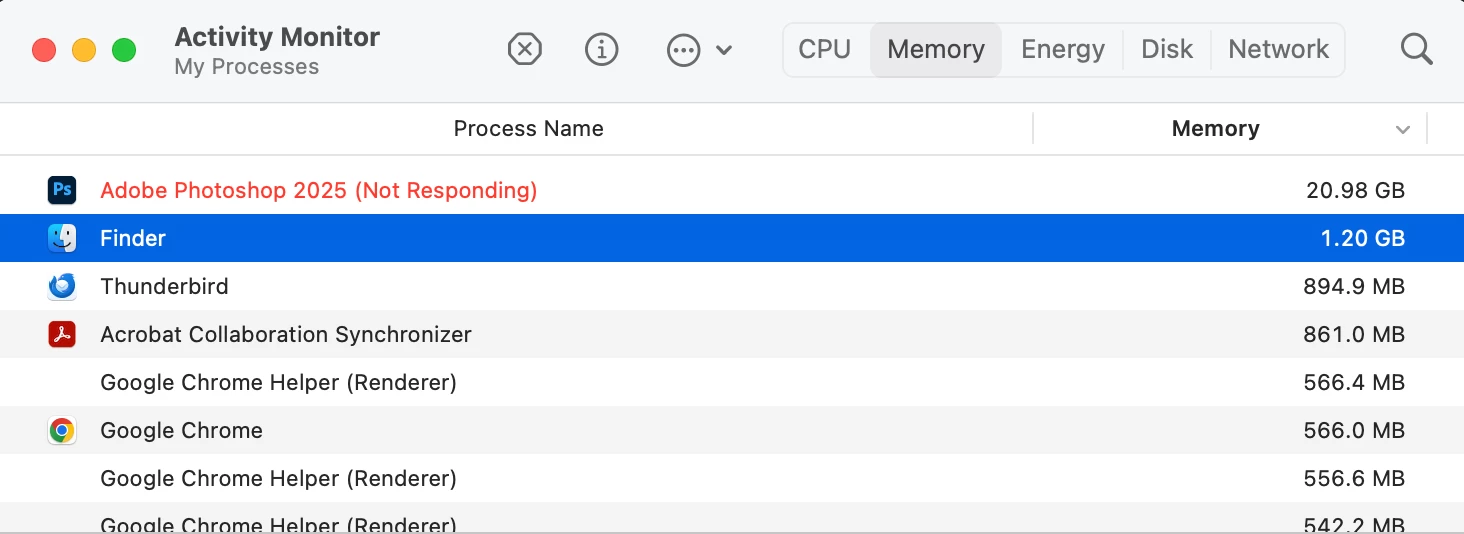

I've attached the System Info from PS 2025 help. Photoshop 2025 had been open with no files open overnight with my laptop asleep and was not responding when I tried to quit it with 20.98 GB memory usage. Screenshot attached too.
Thanks again for your fast response and your help

Hi @Bekf curious how you figured you had 20.98 GB memory usage when your computer only has 8 GB total and only ~5 GB for Photoshop (well below minimums). Are you referring to the scratch disk usage?
