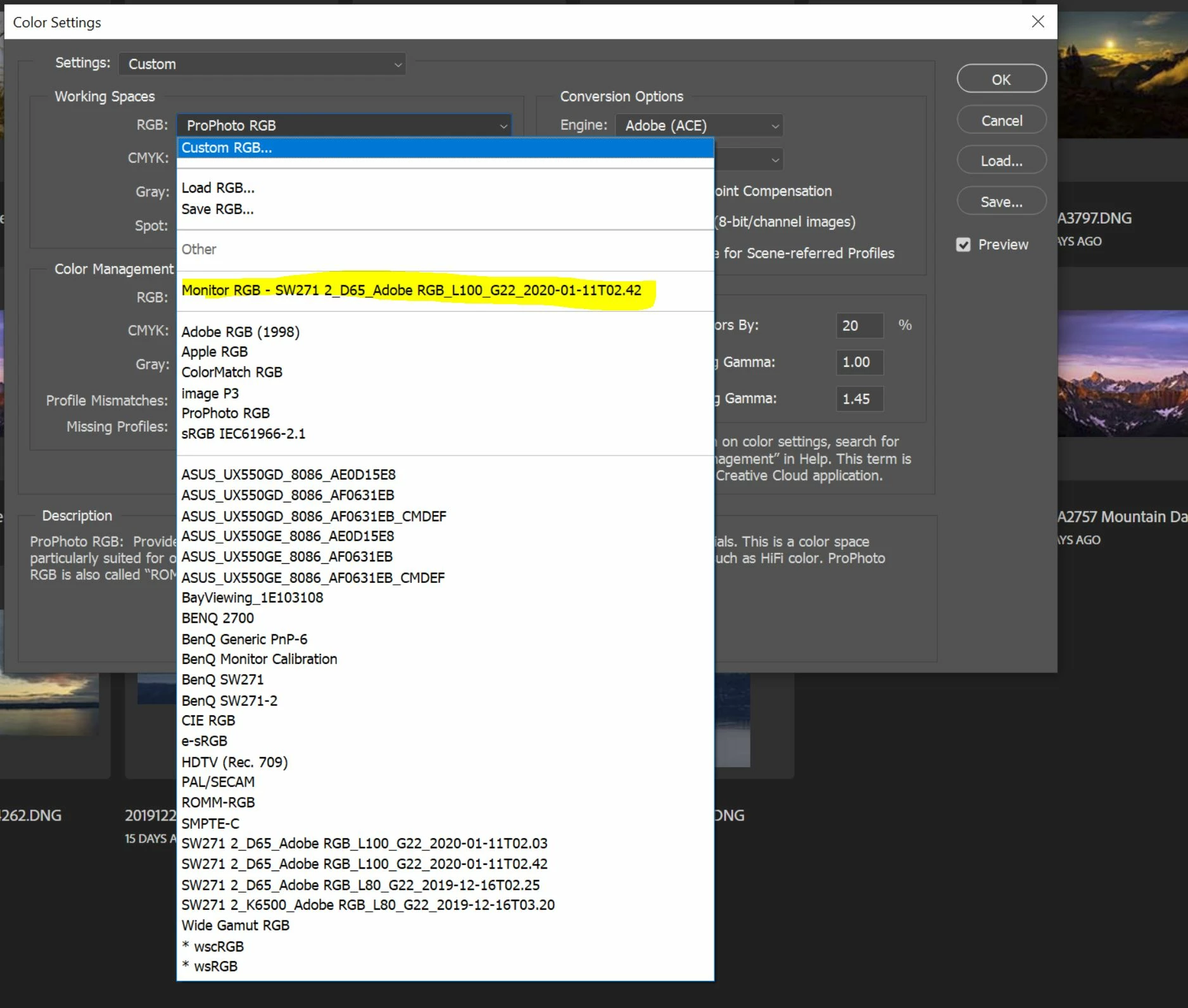

Then, in Photoshop, Color settings > Working Space > and the RGB pulldown, there's a (read-only, I-presume) listing for the monitor profile for the primary monitor. Doesn't matter what monitor you have the Photoshop window on, it shows the selected profile for the primary one. Ouch again.
Yes, as stated in this thread, Photoshop does appear to use the right profile for whatever monitor Photoshop's window appears on. And, yes, if you set a crazy profile for one monitor and drag the Photoshop window from one monitor to the other, you will see the colors change as you cross the midpoint of the window. In my Mac's case, dragging the image back to the monitor from whence it came yielded posterized colors. Closing the image and reopening it fixed matters.
So, once you have confirmed via the operating system that the right profile is set for each monitor and satisfied yourself via crazy-color-dragging that Photoshop is correctly understanding which on which monitor its window sits, you should be able to be confident that you have things set right.

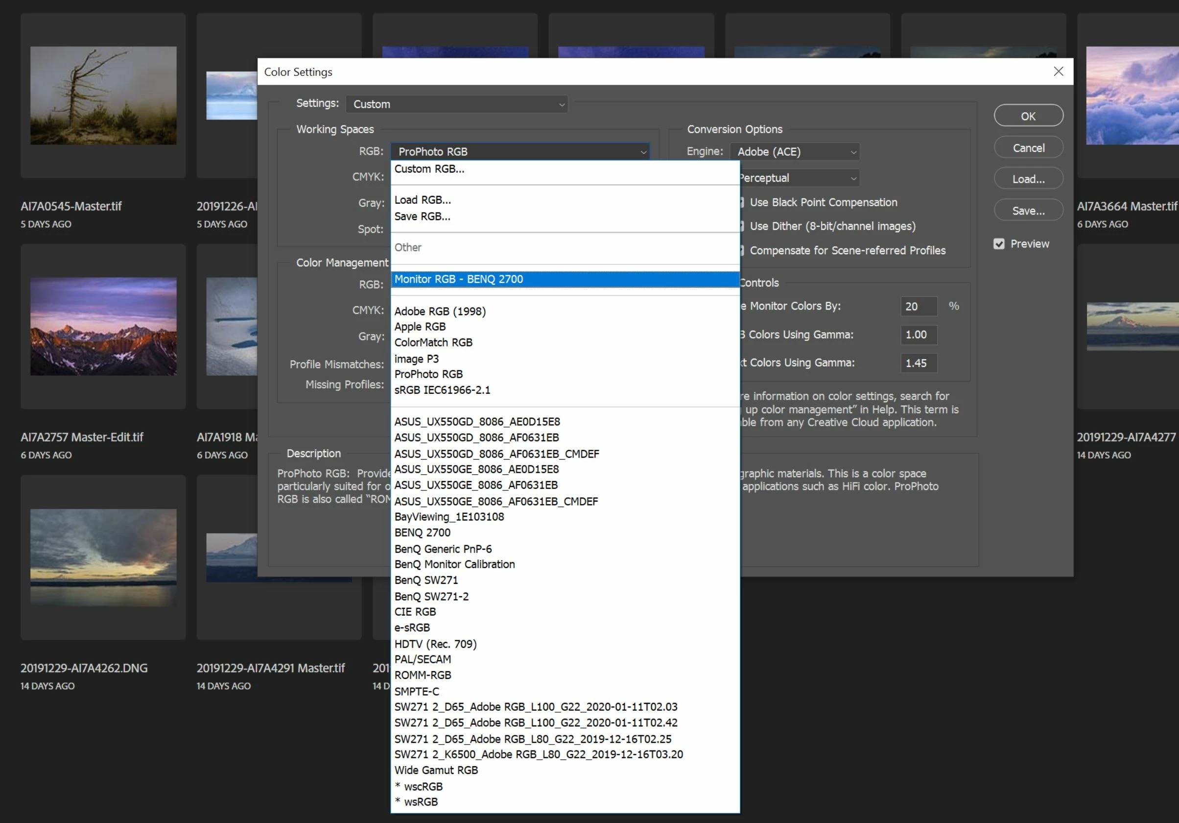

Normally this is entirely unproblematic. Photoshop will use the correct profile for whatever screen it's on. It doesn't matter where the application opens, and it doesn't matter where you move it. The correct profile is picked up once you drag and drop it across the 50% line.
That's how it should work, and that's how it works here (confirmed by testing).
EDIT: actually that's a bit inaccurate, because it's not tied to the app frame, but the image frame. You can have one image on one screen, and another on the other screen, away from the app frame - and they are both correctly color managed. Each using its own monitor profile.
What this problem affecting laptop setups is, I don't know. I've even posted it on the feedback forum after a period of frequent posts here - but there wasn't a single reply from anyone. The thread simply died.

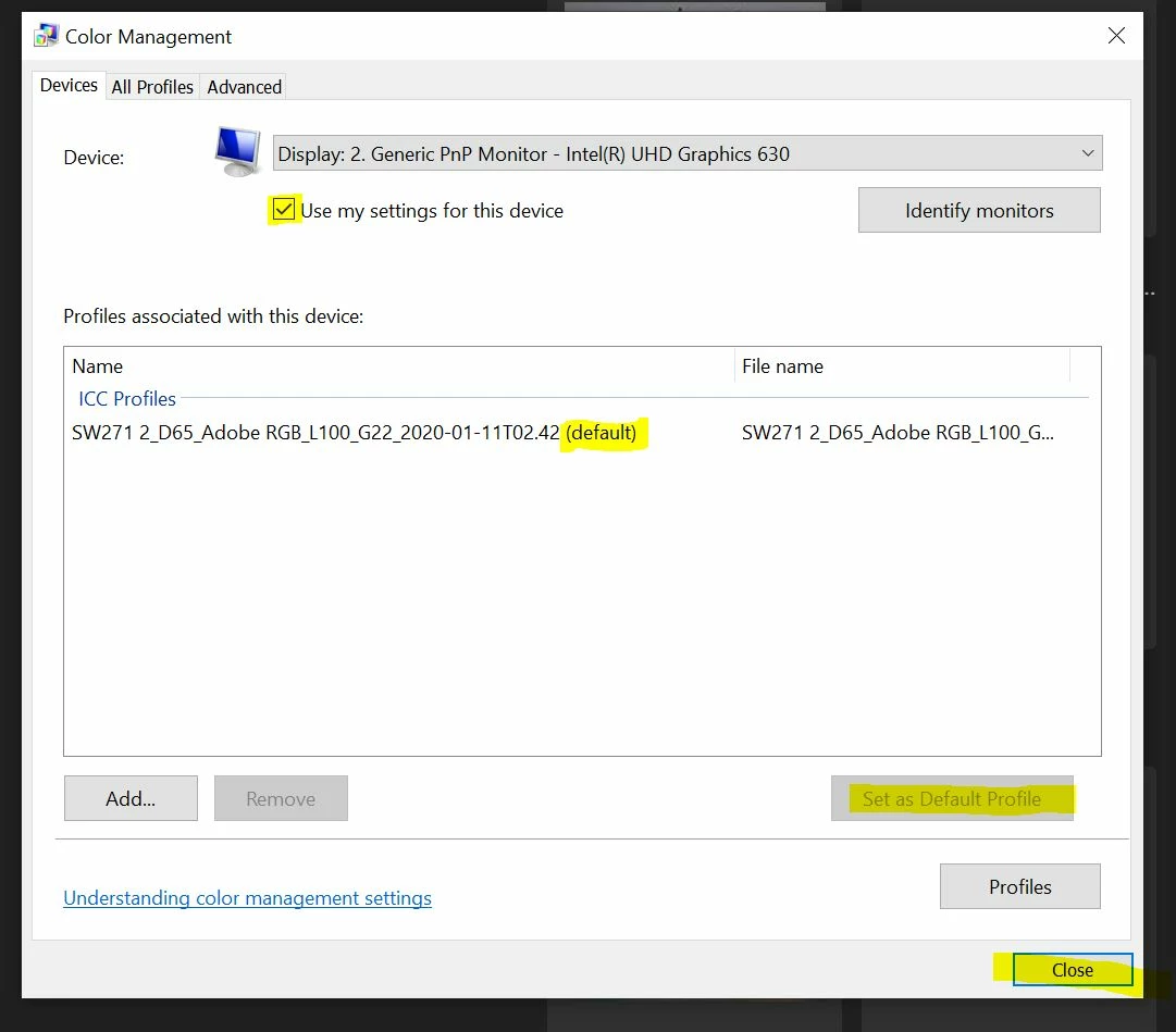

Your working space is completely separate from your monitor profile. The monitor profile should only be set in the operating system.
Forget that you only see one of the monitor profiles in that list, it is irrelevant. If you want to check that Photoshop is using the correct system set profile for each monitor - set a profile in the operating system for one of the monitors that is completely inaccurate. The purpose is to throw off the colours on that monitor in a very visible way (I made an RGB Linear profile to test this).

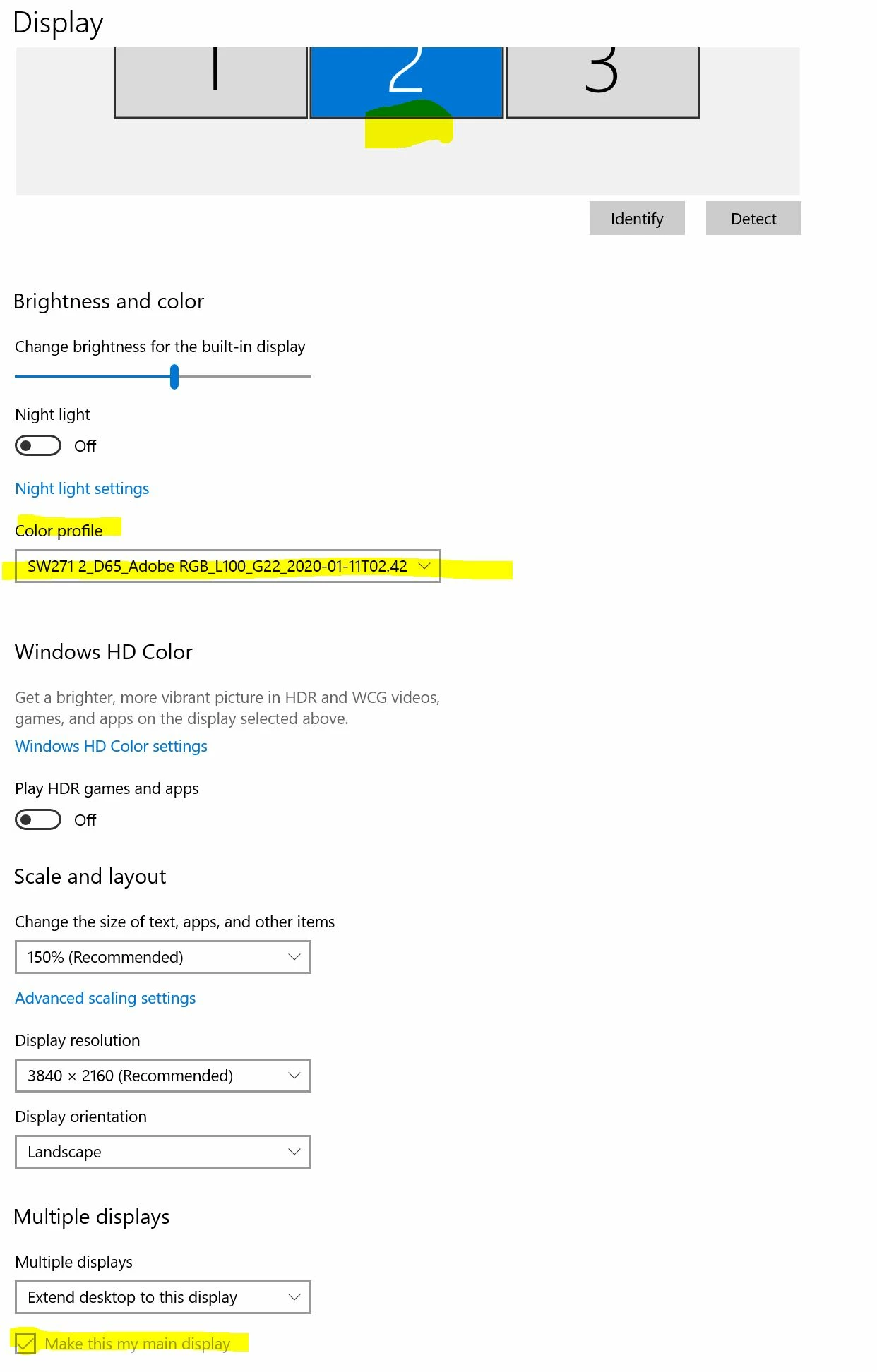

Cautiously optomistic that I solved the problem. Here is what I did.
  • In Windows> Display Settings I changed the BenQ Sw271 to be the primary Monitor.
  • In Windows>Color Management Control Panel> Devices - I confirmed the display, confirmed the icc profile and then checked "use my settings", checked "Set as Default"
  • Opened PS which unexpectedly opened on my laptop screen. So, dragged it to the BenQSW271, made sure it wasn't maximized and closed out of PS. Re-opened PS and it opened on the BenQ SW271. (something I learned from another thread dealing with this issue)
  • Went to PS>Edit>Color Settings>Working Spaces>RGB drop down and found that the BenQ SW271 profile was now listed as Monitor RGB - SW271
