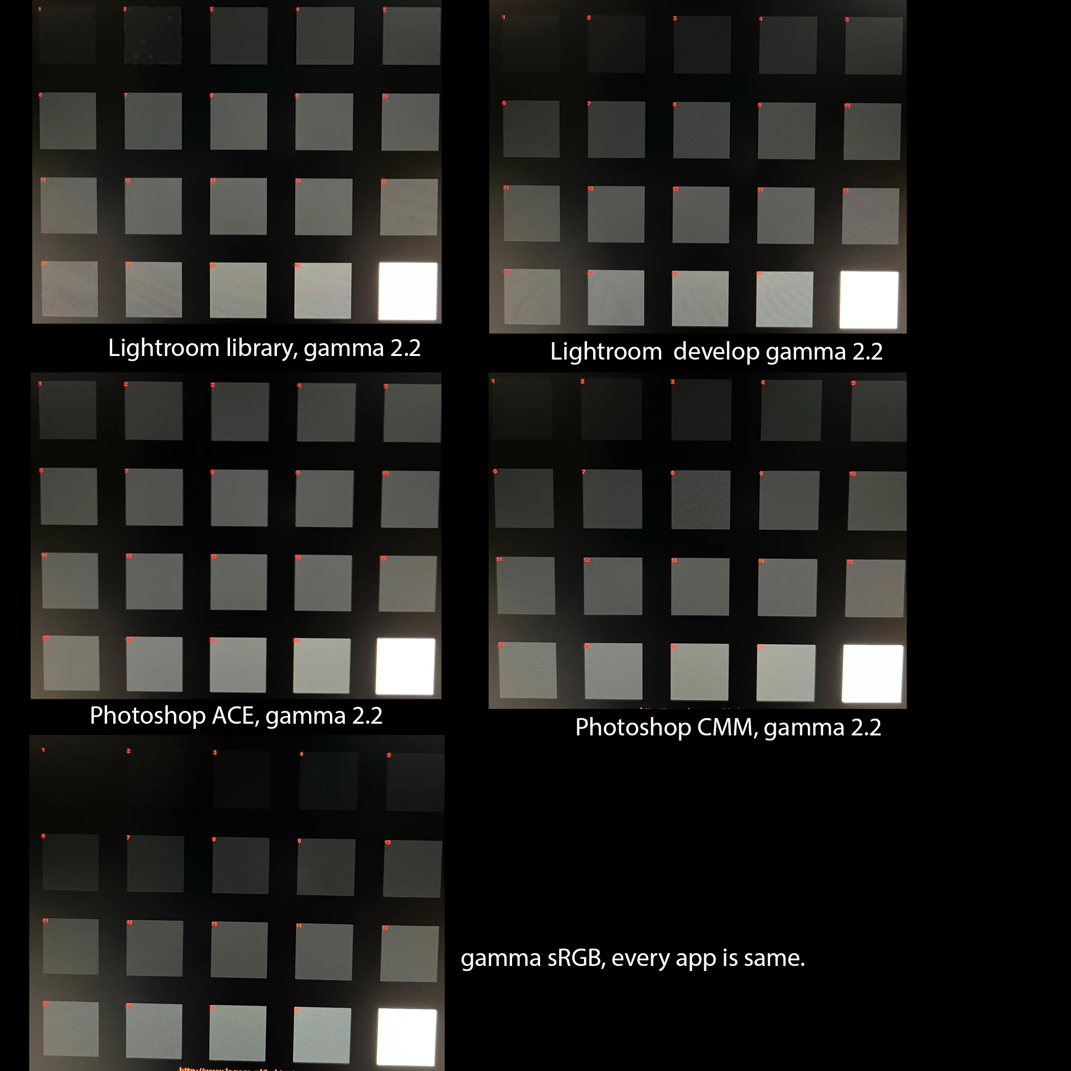

Hi @riccknl , @D Fosse , @NB, colourmanagement ,
I am experiencing the same problem on my MacBook Air M1, so it’s not limited to M2 chips.
I’ve been struggling with this issue for almost four weeks now, and there’s still no solution.
I compared the results with a Windows machine / gamma 2.2, and the best workaround I’ve found is to set Photoshop’s color management to Apple CMM (best matchs). Adobe ACE doesn’t seem to work (sorry, Apple!).
The Lightroom Library module is also problematic. However, the Lightroom Develop module appears consistent with Apple CMM, as does Photoshop when using Apple’s CMM.
When I calibrate and profile my Windows machine and compare it to macOS (same monitor), the closest match I get is with Lightroom Develop and Photoshop set to Apple CMM.
At this point, I’m not even sure what’s accurate anymore. Most Apple displays and tablets with good screens seem to show a perfect sRGB gamma curve. Gamma 2.2 lifts the RGB 1 values to around RGB 3 (also on windows), while Photoshop ACE increases them to RGB 6!
Here’s a link to my thread on DisplayCAL:
https://hub.displaycal.net/forums/topic/black-levels-at-standard-srgb-icc-vs-profiled-icc/page/2/
Detailed comperassion with Windows vs macOS: https://hub.displaycal.net/forums/topic/black-levels-at-standard-srgb-icc-vs-profiled-icc/page/2/#post-142534
By the way, if you set your Tone Curve to sRGB, there’s no issue—everything across apps and macOS aligns. The problem arises when profiling is applied with gamma 2.2. I'm now considering to use sRGB gamma curve, because it's best match with most common devices, monitors, tablets, cellphones. But i dont know witch is correct anymore 😃
If there’s any further news, please let me know.

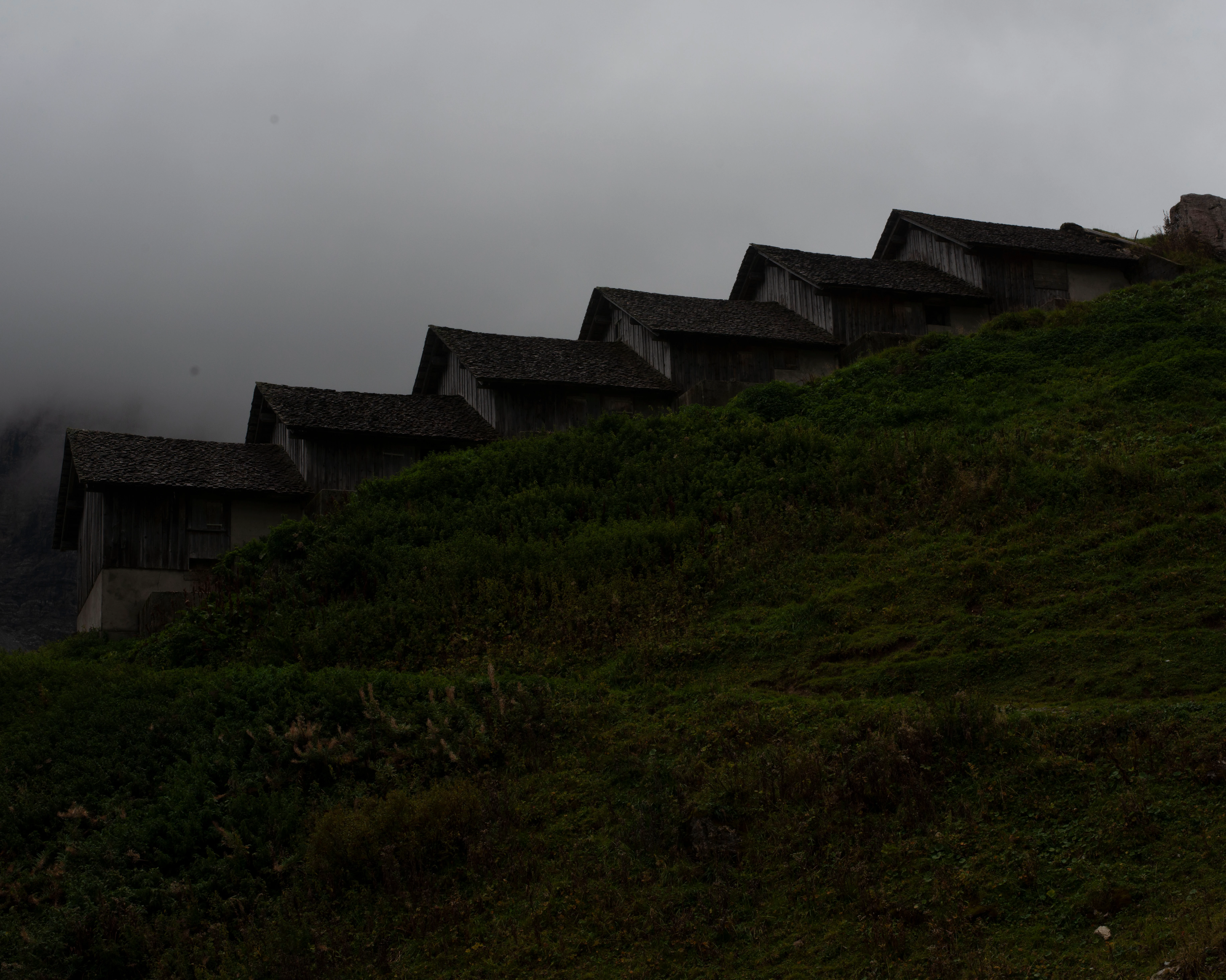

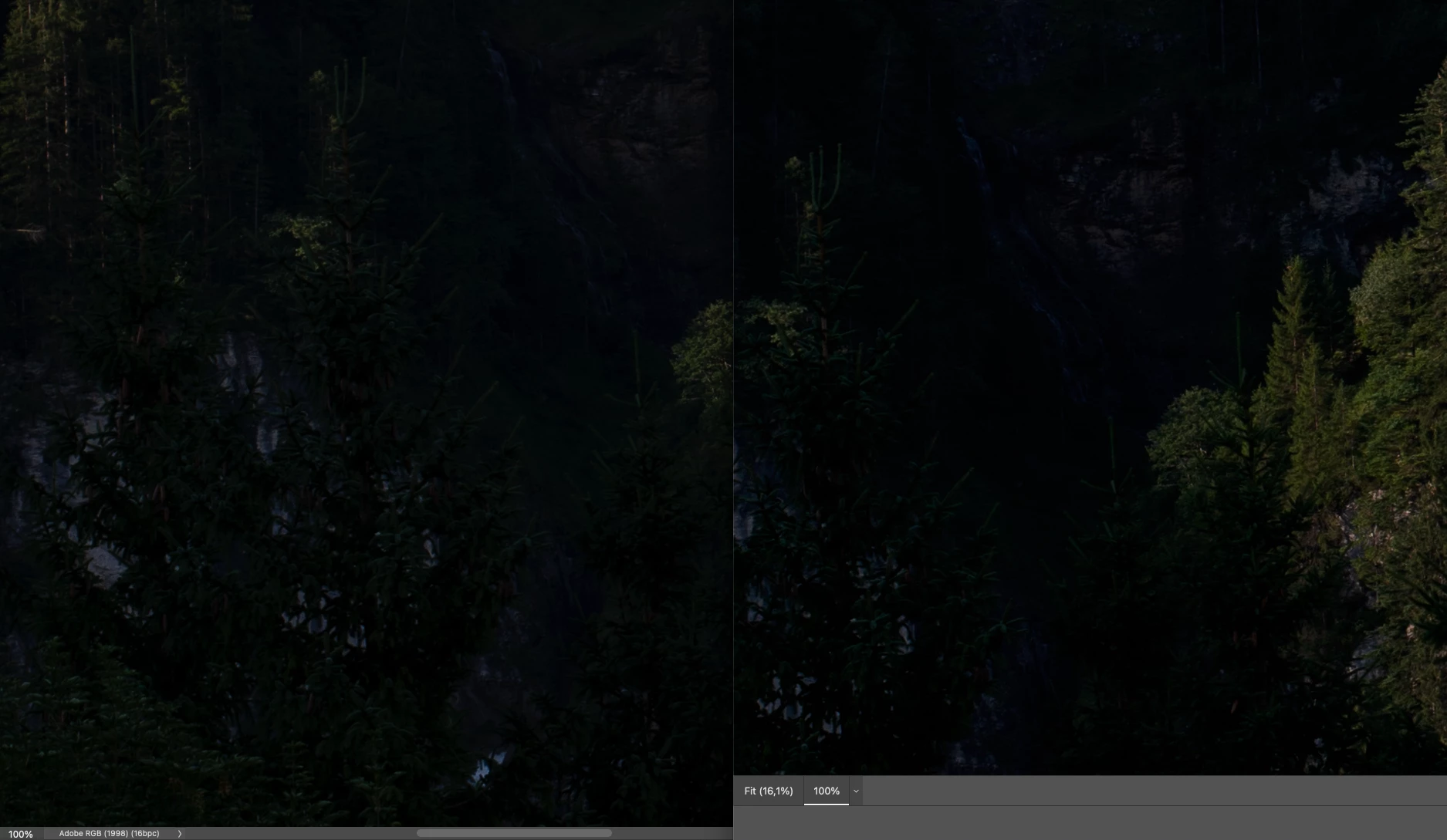

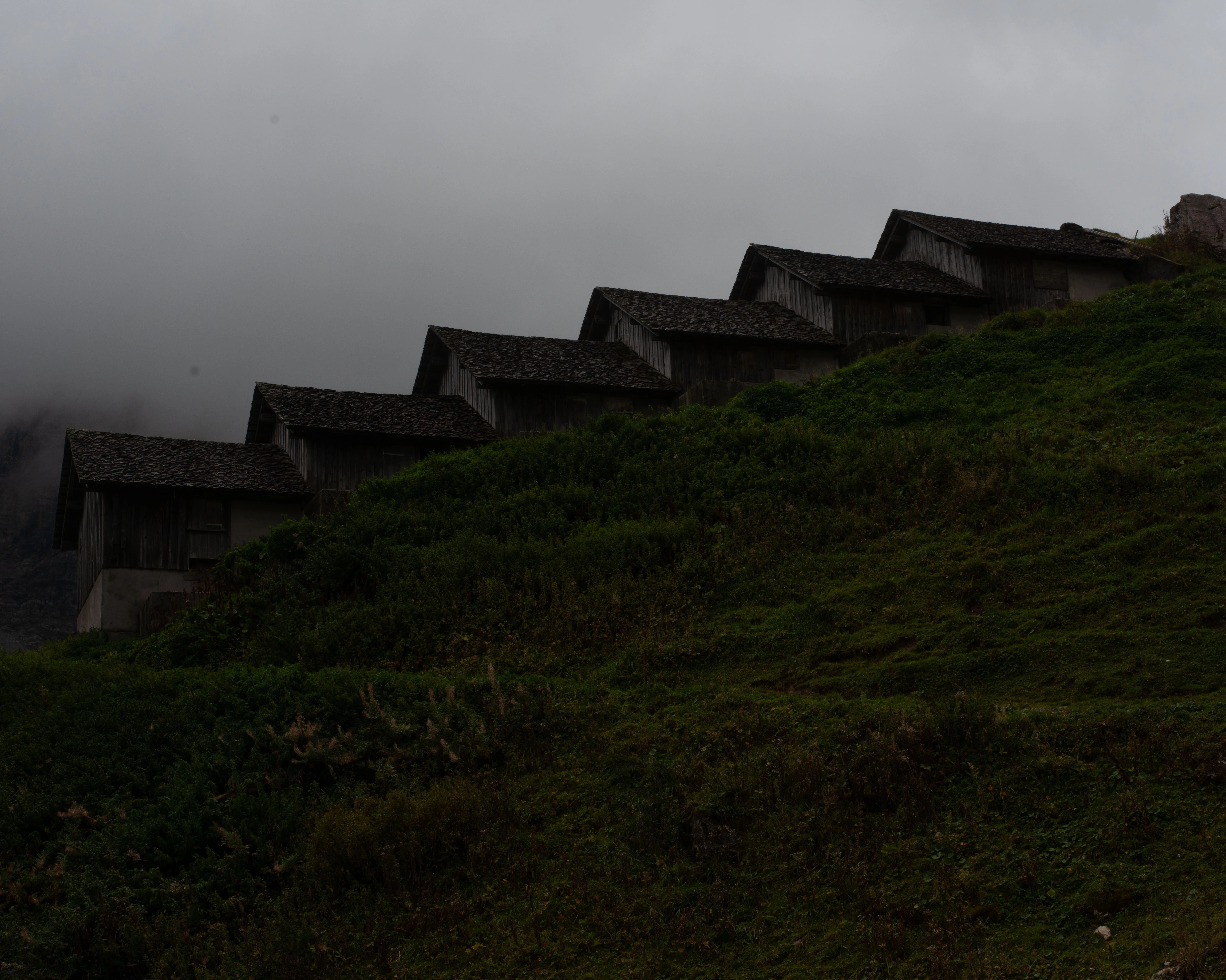

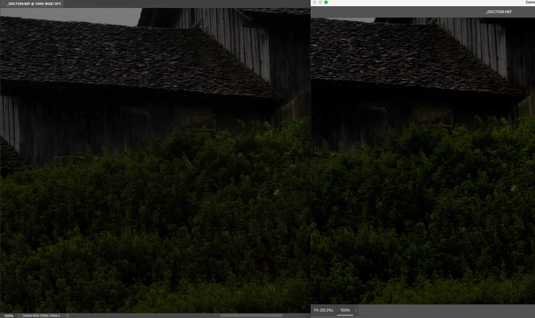

@NB, colourmanagement The problem is that my photographs, either NEF, JPG etc are getting lifted in the shadow/black values of the image in Photoshop. The youtube link also shows the slight elevation and 'muddiness' happening in the shadow areas on my iPad and iPhone which aren't color calibrated.
@D Fosse I added screenshots from ACR/PS compared. Also a image exported by ACR and one by PS, marked with PS left-upper corner. I had to bring back the P3 monitor because of the return period.
Adobe Customer Service keeps asking me to start a chat, but they abandon the chat without replying. But last night they sent me an email that it could be a problem with the M2 chips. Only to ask me once again to open up a chat.

What I see in these screenshots is channel clipping.
In example #1, ACR clips the red channel. The other two channels are unaffected.
In the jpeg, #3 shows blue channel clipping. The other two channels are unaffected.
This kind of channel clipping is historically typical of a bad/defective monitor profile - but here's the thing: the conversion into the monitor profile is executed in the GPU nowadays. That means a buggy GPU driver can throw the conversion off, and that's what I think happens here.
In other words, monitor profile <> GPU driver is very much two sides to the same coin now. A marginal profile can throw the GPU off, and a buggy driver can cause the profile to fail. Both need to be in good order.
The lighter shadows is the correct version.
I've doubled checked here and I'm not seeing this on Windows. ACR and Photoshop are absolutely identical in the dark values. So there's nothing inherent in Photoshop.
ACR won't work without the GPU now, but LrC does, so you could try to disable the GPU there and compare again.
