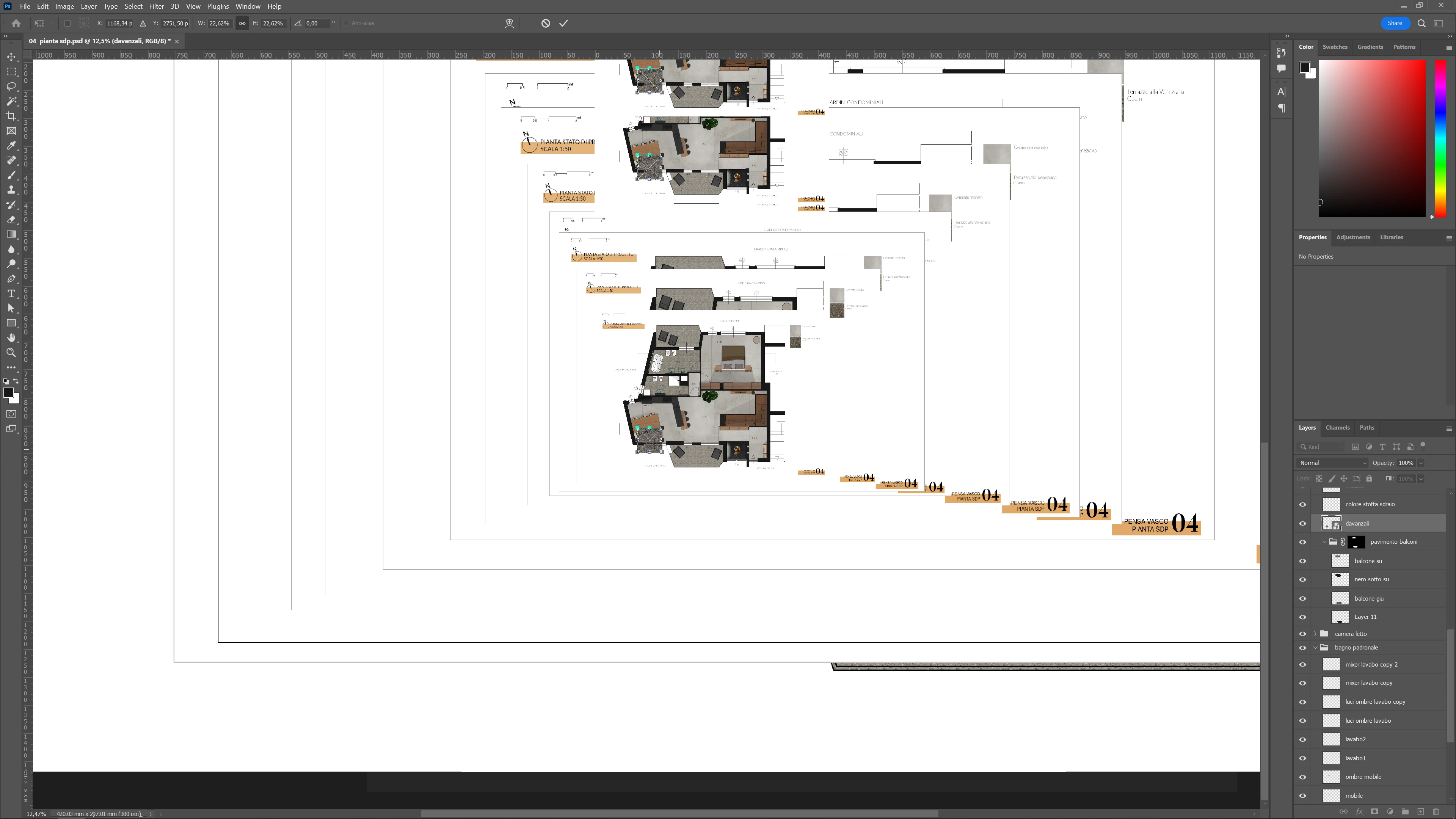

un the last week photoshop has been acting up; no matter my preferences it uses too much ram, opening photoshop with no file uses 7 gb of ram, opening 1 160 mb file uses 9 and 2 160 mb files uses 12 gb of ram (my limit is set to 8).
the app crashes every 10/15 mins because of this, i updated ps, tried to uninstall and reinstall and even bought a new ssd and did a clean install of windows.  i need to use it for a project due in a week and cant, im screwed

Go to Preferences > Performance... and uncheck both Multithreaded Compositing  and GPU Compositing - then restart Photoshop. Does the problem still occur?

Dramenon
June 2, 2022
Thank you for the sample file,
Does all your work have Smart Objects with PDF as their Smart Object?

vaschedduAuthor
June 2, 2022
it happened again, every 10 mins even with a new file and a freshly installed version, i have to do a lot of work and i really cant be held back by the program rn. i'll put a link with the file but files are not the problem because with every file it crashes.
it seems like a graphic problem.drive link here

CShubert
June 2, 2022
@vascheddu, would it be possible to share the pdf file you seeing this with? Do you know. what version of Ps and platform your friend has that you sent it to? Any and all info you can share will help the team track down what might be happening.
