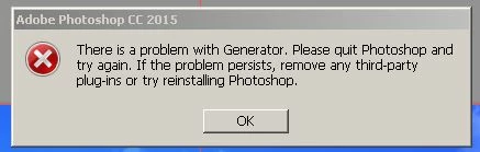

June 14, 2016
I had the same issue...
Adobe Generator was behaving weirdly prior to the file size issue...
so I just had to bite the bullet and reinstalled Photoshop. All's right with the world again.
