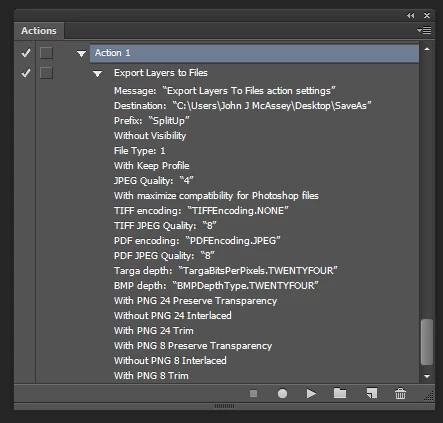

You did not state which version of Photoshop you using.   I'm not sure if export layers to files was always a plug-in.  Expand your actions export layers to file step. Make surre you set your setting have been recorded iti that step.
