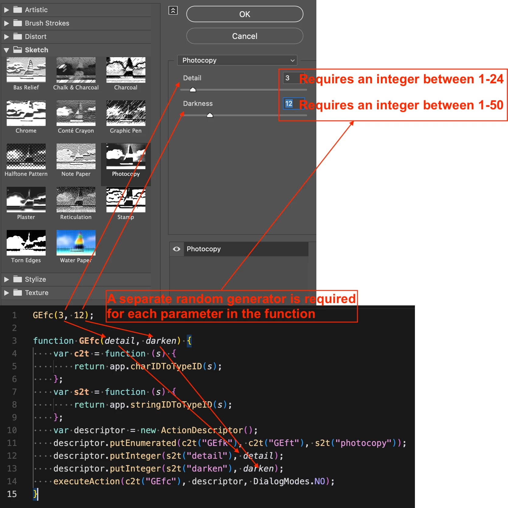

Stephen Marsh
March 2, 2025
Here is a visual example of the how the Photocopy filter would be scripted, using fixed parameters. These fixed parameters would need to be replaced with variables from random generators.
And here is an example of how this would be scripted:
var photocopyRandomDetail = Math.floor(Math.random() * 24) + 1;  // Random integer between 1-24
var photocopyRandomDarken = Math.floor(Math.random() * 50) + 1;  // Random integer between 1-50
GEfc_photocopy(photocopyRandomDetail, photocopyRandomDarken);
function GEfc_photocopy(detail, darken) {
    var c2t = function (s) {
        return app.charIDToTypeID(s);
    var s2t = function (s) {
        return app.stringIDToTypeID(s);
    var descriptor = new ActionDescriptor();
    descriptor.putEnumerated(c2t("GEfk"), c2t("GEft"), s2t("photocopy"));
    descriptor.putInteger(s2t("detail"), detail);
    descriptor.putInteger(s2t("darken"), darken);
    executeAction(c2t("GEfc"), descriptor, DialogModes.NO);
Note: I purposely chose a simple example. Some of the filters use parameters which are not simple integers.
