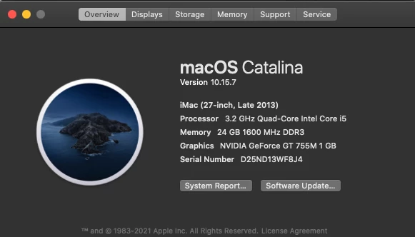

Hi....
I'm having the same problem is is driving me crazier. The only way to get rid of the black spot or line...is by moving the image I'm working with, using the mouse, and goes away, but that is not normal, this started after last update. Performance graphics prosessor is unchecked and greyed out, I reseted the preferences, etc, and no change.
gladysa
June 15, 2021
Problem is fixed!!! I reset the preferences.
EDIT--> PREFERENCES --> GENERAL --> you have to Check off
-> RESET PREFERENCES ON QUIT <—
Close Photoshop then start it back up. Preblem resolved.
Sent from my iPhone. Please excuse any typo errors in my text.
June 17, 2021
Mine is checked off.. still same problem. Its been since 2 updates ago

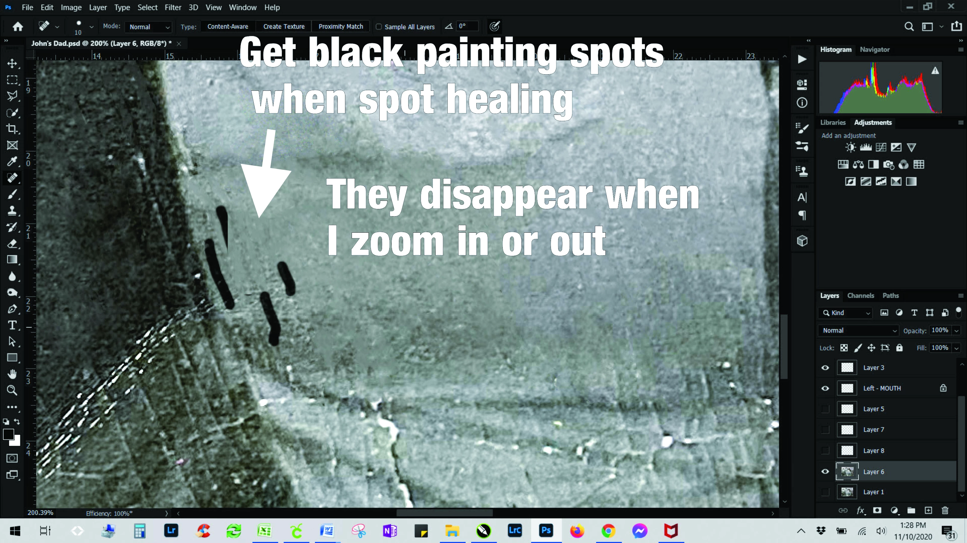

October 9, 2020
Same. Only way to get rid of it is to zoom in or out.
gladysa
November 10, 2020
Hi.. I'm having the same issue. I get the black painting where I'm spot healing. It only goes away when I zoom in or out. I have tried resetting the tool. It keeps happening.
gladysa
gladysaCorrect answer
November 13, 2020
EDIT-->  PREFERENCES -->  GENERAL -->  Check off  RESET PREFERENCES ON QUIT. Close Photoshop then start it back up. Preblem resolved.
