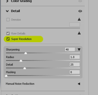

First off, just to get it out of the way, this only works in the Camera Raw processor (the plugin) - not the Camera Raw filter from Photoshop.
Can you check the box here? What happens then? Something or nothing?

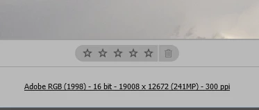

If the process runs, what's the size indicated here?
And thirdly, what GPU do you have?
