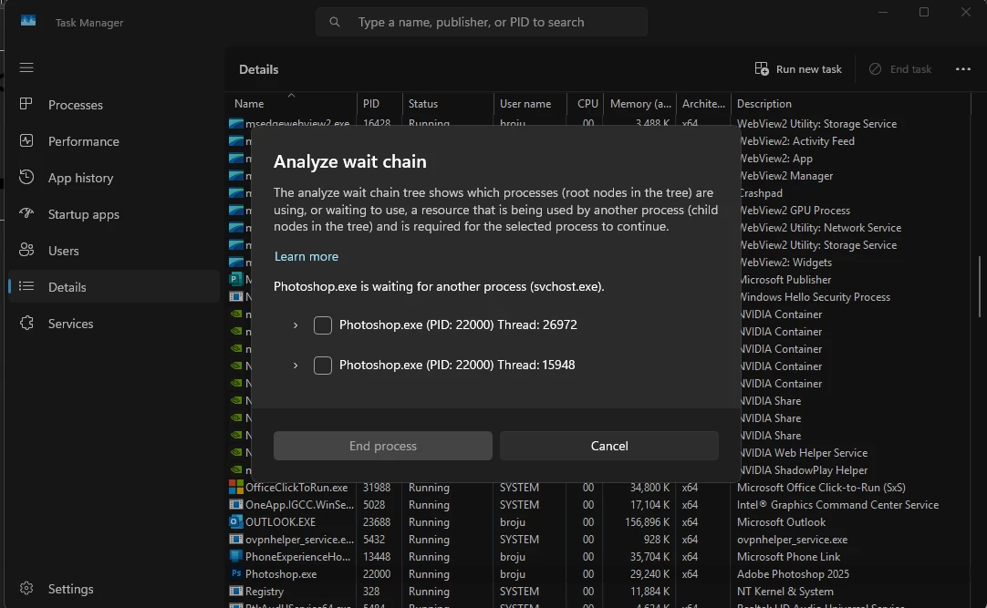

Possible fix if you have a large font library or a font manager: in Photoshop go to Type > Font Preview Size > None.
My case: Photoshop 27.4 on Windows 11 was unresponsive for 1-2 minutes after opening a document, then ran fine. I recorded what Windows was doing during the freeze. fontdrvhost and the System process were busy, Windows Defender was scanning at the same time, and my font manager (FontBase) had about 1,000 font families active. Quitting the font manager fixed it.
So I thought : what if Photoshop, as dumb as it is, is the only program to generate a thumbnail for EACH type, even if not needed and for EACH DOCUMENT?
And yes, it does.
So setting Font Preview Size to None fixed it. and I can keep the font manager running.
This may not be your cause, but if your freeze comes with a lot of installed or activated fonts, it is a quick thing to try.
