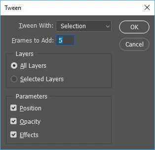

    If you tried to use tween the only transform I have used the works is one that moves the layer position from frame to frame.  I tried rotation and that does not work in a frame animation perhaps because of the interpolation required would loose to much image quality.  If that is the case resizing would also not be possible.   Move only requires shifting the existing pixels position over the canvas.  Tween options are  position, opacity and effects.  In this animation there are two layer that are visible in all frames.  I create the first and last frames.  And moved the top layers position between the first and last frames.  I then used Photoshop tween feature to generate the frames between the first and last frames.  The top layer also has a layer mask the is not linked to the layer's content. So the mask does not move.  The mask is also more a mask  for the bottom layer content not the top layers content.

    I have tried all three options of parameters.  I have tried for the selected and all layers.  My first problem is that when I duplicate a frame, then free transform the image to the desired new location, the original frame transforms, as well.  I am not able to make the two frames remain in the desired location to even move on to the tween step.  It worked fine last a few weeks ago, but since one of the updates, no longer works.

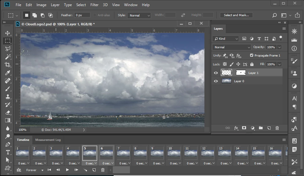

    Because you changed the layers pixels.   You have to create additional layer for the frames you want  to be created.  Tween only supports positioning the move tool aspect of transform.  It does not support rotation, resizing or distortion.  It is easy do duplicate layers and transform them to create the content you need for the frames between frames you have or simply the next frame.   If only one layer is involved recording simple actions should ease the process.  The Pulsating and rotating animations I posted  I made with one layer.  The layer was duped and transform by a simple action. Every time I clicked play a layers was created for the next frame.  I then used make frames from layers. You can not use tween to generate the frames you want.
    The original layer should not transform nor should any existing frame. If new layer visible in all frames is not checked.  Only duplicated new layers are transformed. The new layers created should not be in any frame till you add new frames to the animation that you make them visible in.

    How are new layer added to your frames animation? Check the Frame animation Fly-out menu will the be visible in all frames?
