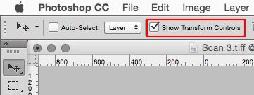

Oh no no, in the heading of this thread I said even though "show transform controls" is on. Thats the issue. Even though thats ticked on they will disappear. You can click that on and off as much as you like they aren't going to return unless you go into freeze transform mode and out again.

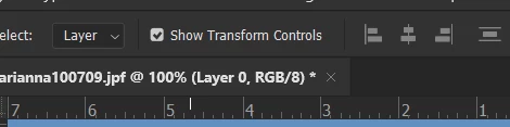

Maybe you just need to check Show Transform Controls in the tool options for the Move Tool.
July 17, 2015
Next time it happens I'll try that one out as well,
