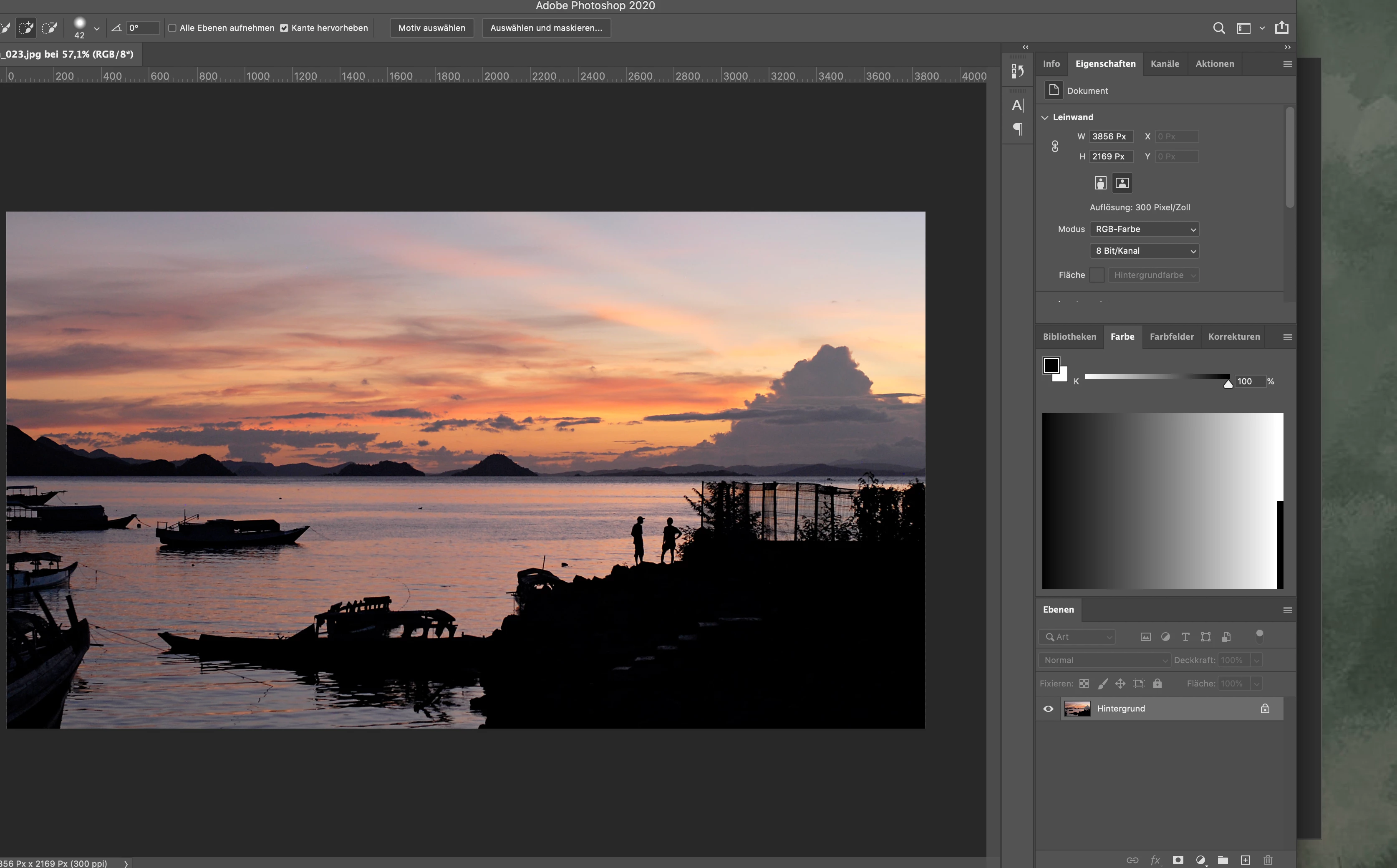

Photoshop WINDOW is not centered, moves out of the screen/display + TABS do not react
Hey!
Hope I can describe my Photoshop issue in English.
On my last Macbook Pro 2016 13" and on my new one 2019 15" I have this issue most of the time with photoshop - I think not at all with the other software of the Adobe Creative Cloud.
Issue:
As you can see in the screenshot my Photoshop window moves out of the viewport/display of my Macbook (to the left). This happens quite often after I am working for some time with Photoshop and switching between Photoshop and a browser, other CC software… It is not only that I have to move it back to the center of the window in order to see everything.
The second part of the issue are the openend tabs in Photoshop: they suddenly do not react anymore, when I click on them. The workaround I use since months is to click on the right side of the window an drag it a little bit smaller or bigger. This does actually activate the chosen tab and I can continue working.

Have you tried to resize your display resolution to center the program window again?
System Preferences > Displays > Resolution: Scaled
I had the same problem switching from a two-screens setup and a single one, and this trick solved it

Issue #1
Have a look at the Overscroll option within the Tools tab of the Photoshop preferences.
Issue #2
If default Photoshop behaviour ever starts to change, a good solution is often to reset the preferences.

Jun 15, 2020 1:01 PM UTC
Thank you Michael!
I did reset the preferences and turned on the Overscroll option.
I will check if it worked or not and tell you what happened.

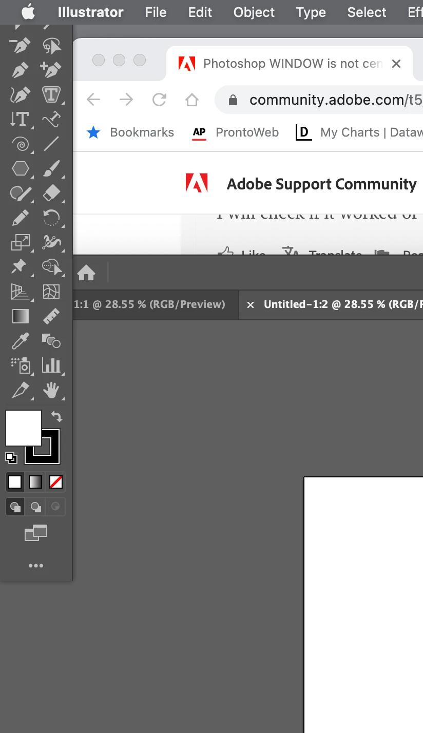

Update:
- I had the same issue with Adobe Illustrator now once as well
- I tried to solve the problem by turning off the Settings > Mission Control > Group Windows by Application, but I did not work (https://community.adobe.com/t5/photoshop/photoshop-window-on-mac-keeps-moving-off-screen/td-p/6815374?page=1)

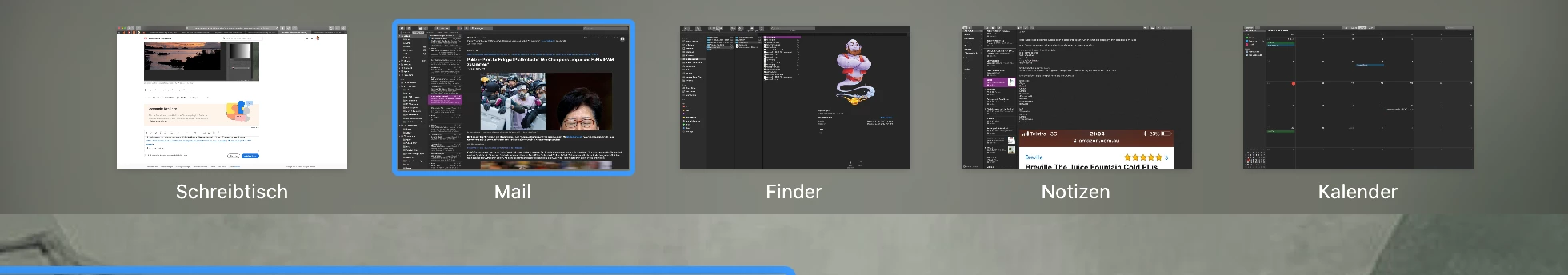

- I have read that the different spaces (multiple desktops) I use on my Mac might be the reason for the interference (see screenshot)
- because I already did a reinstall of the CC products three months ago, I do not think this can solve the issue, but if there are no other suggestions I might just go for it.
