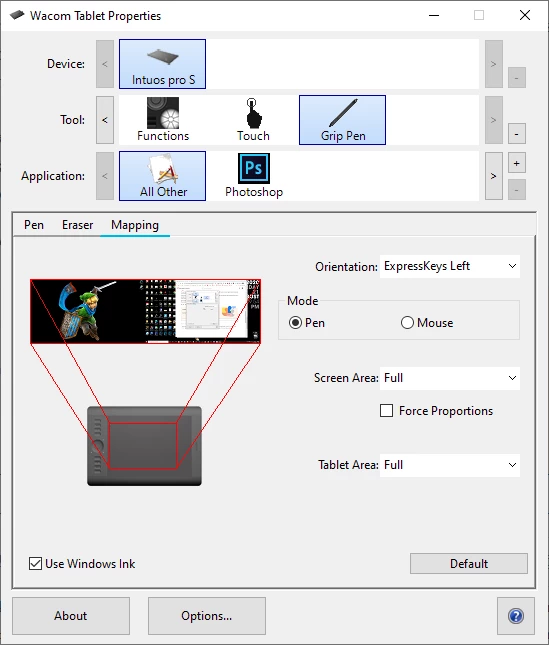

Adobe broke Photoshop WinTab support is CC 2019 update 20.1 you can not use WinTab support with photoshop version 20.1 and newer like 21.2.2.  Remove the PSUserConfig.txt from your Photoshop Preferences folder and check Use Window INK in your Wacom Preferences.

An unexpected solution was found when I enabled Windows Ink on my settings, now it is working fine
