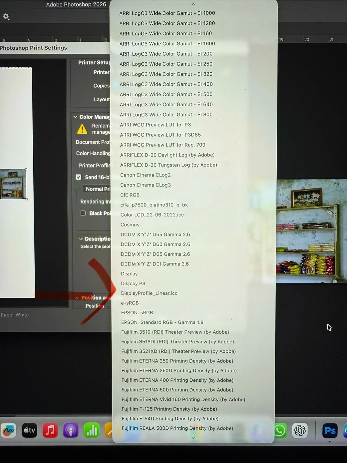

Photoshop wont Print nor show ICC Profiles
Hi. My problem is that Photoshop Print Menu is not showing the Epson ICC Profiles. I deinstalled and reinstalled the Epson driver, updated the firmware etc and it made it worse. The print menu now is not only missing the ICC Profiles, it is also missing some sections, plus a bogus menu comes instead of the original one. It wont even read the custom paper sizes. Even if I hit print, it won't print due to a 'missing software' issue. Anyone?

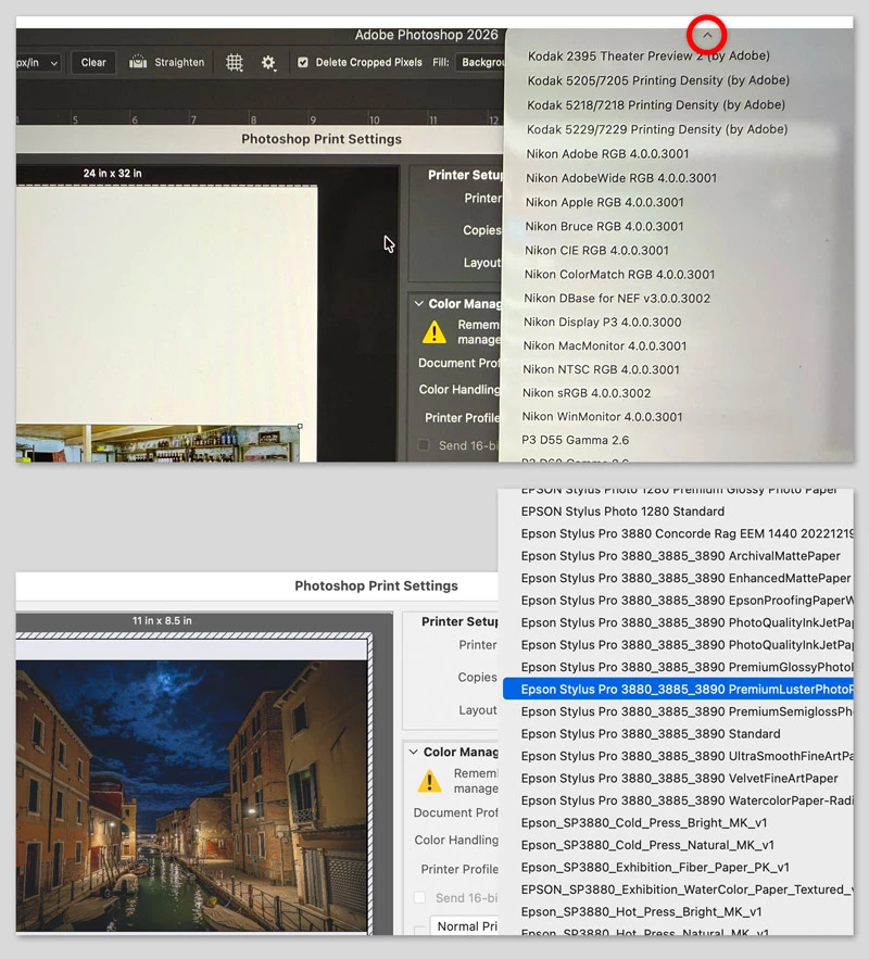

The Print dialog box should be listing profiles alphabetically, so why is your attached image IMG_4554.jpg showing K through R? Can you see the Epson profiles if you scroll up to where the E names would be listed?
The Photoshop profile menu can be very long, partly because for some unknown reason the Printer Profile menu lists profiles that have nothing to do with printing, like ACES and Rec.2020 which are for video editing only. Here is a tip for quickly scrolling to the Epson profiles: After clicking open the Printer Profile menu, type E to go to the first menu item starting with E.
If the profiles are properly installed, they should show up in the E names as shown in the bottom half of picture below.

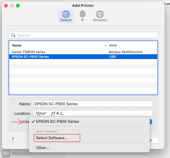

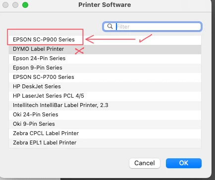

Hi, it's not quite clear to me whether the issue is resolved for you, but having spent the last 7 hours also wrestling with this infuriating issue too, I'm sharing the solution that eventually worked for me - this time at least. Pay particular attention to parts in bold; this appears to be the problem, which I suspect is down to Apple rather than Adobe (although one would hope Adobe would know about it!).
Setup: Mac M3 Sequoia 15.6.1 and PS V 27.0.0
  1. Quit PS and LrC
  2. Mac settings > Remove printer
  3. Epson > download and install latest printer driver. (Yep, again, even if you did just update it to latest version via Epson S/W Updater. No idea why, I can only share what worked or didn't, and updating via Ep S/W Installer didn't help).
  4. Epson Media Installer > check desired ICC profiles are still downloaded and show as On PC / On printer. (If not, Refresh. If that doens't work, select profiles > Download again).
  5. Mac Settings > add printer > Use: [your printer model]. (💡Don't apply logic here and skip this!! Seeing correct printer in this field doesn't guarantee it's the printer PS is looking at. CLICK ON PRINTER NAME to reveal hidden menu.
  6. Select software > pick correct printer from list > Add. (On mine it defaults to the second one down, Dymo. This appears to be the issue causing our problem. (This time anyway).
  7. Check Kind shows [your printer model] and Mac O/S hasn't hijacked it to use AirPrint (ie Kind: shows Epson, not AirPrint. If it does show AirPrint, hit Remove and start again).
  8. Re-start Photoshop
  9. Print > color handling: Photoshop > ICC profiles should now visible in Printer Profile list.

@ZappaJul Yeah as I explained above that's the AIRPRINT driver issue, selecting that in "use" when adding the printer loads a generic driver missing a load of features like proper paper names etc..
I THINK the OP's [ @guillermosh ] issue was mainly not seeing ICC profiles listed in the 'Photoshop Manages Color' list, but they were apparently also using what looked like the AIRPRINT driver, which wouldn't have been helping print appearance.

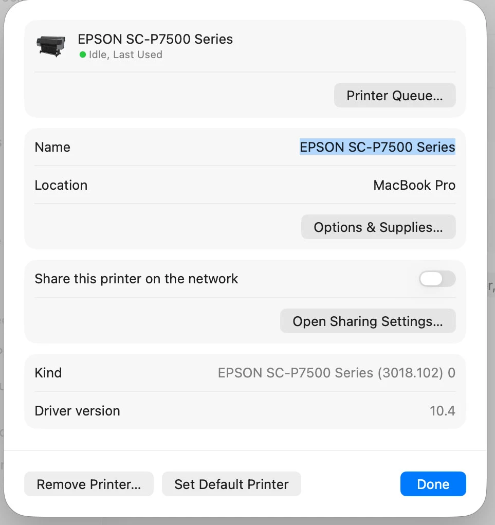

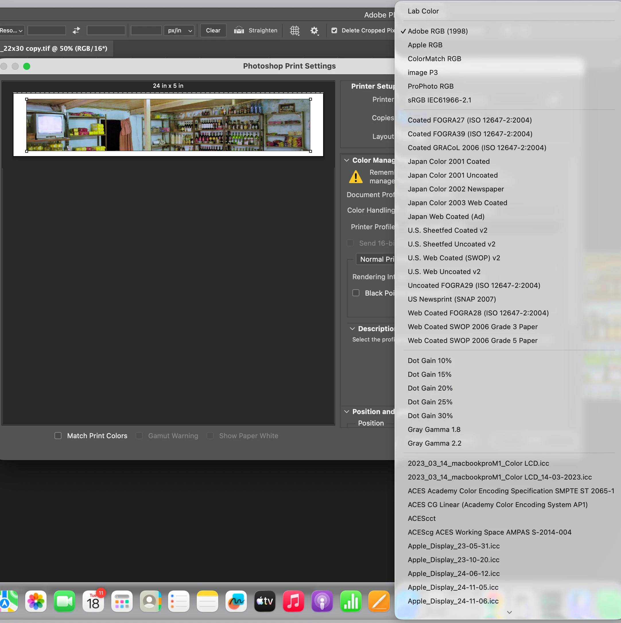

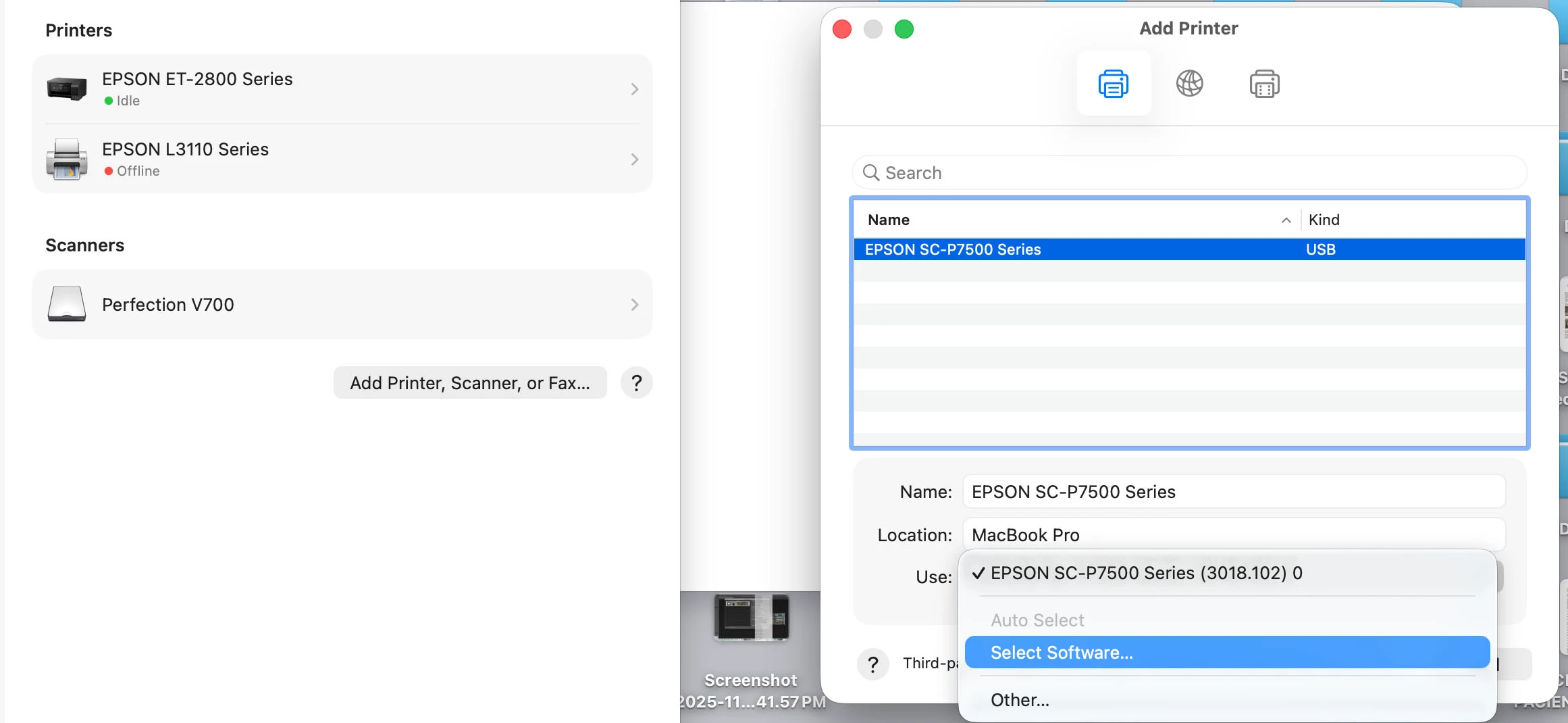

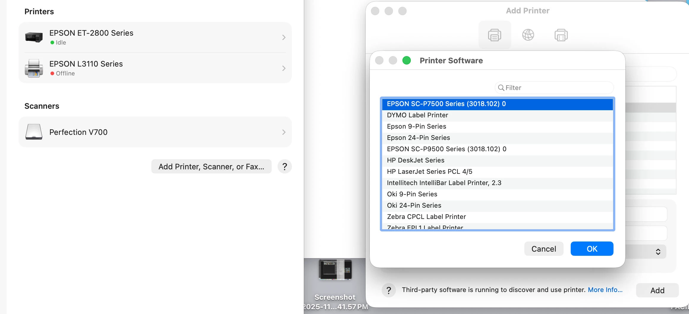

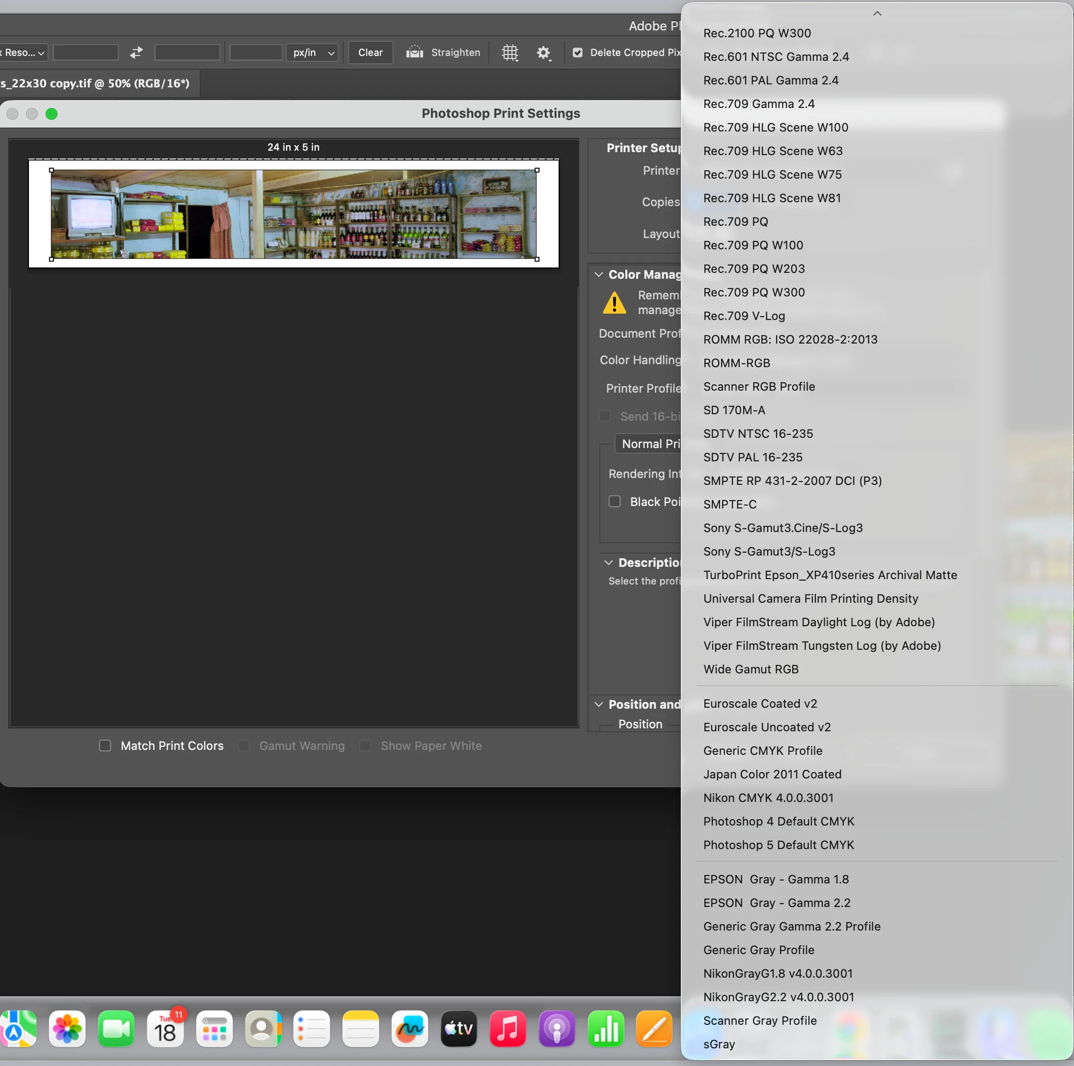

Hi @ZappaJul and NB, I have followed all your recommendations and still nothing.
The one thing that is not popping up is the AirPrint option.
These are the steps you recommend, with their corresponding screenshots:
1- Delete printer
2- Download and install Epson Driver
3- Add printer and click Use.
4- Select Software. Select the printer name. OK.
4-
4- Reopen Photoshop. Look for the Epson ICC Profiles. *Nothing comes up!*

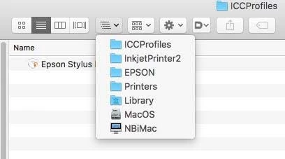

Navigate to

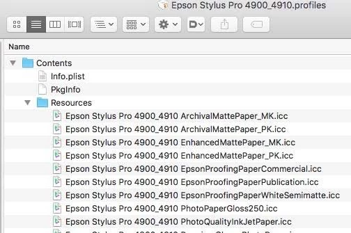

“Your hard disk name”/library/ printers/EPSON/InkjetPrinter2/ICCProfiles/ [hidden inside a “package”]
[Not in the “your username”/library/ ]
Screenshot below
Inside the ICCProfiles folder (see above) is another folder containing the printer name, e.g:  Epson Stylus Pro 4900_4910.profiles
If you right click [or ‘control’ click] it and select "show package contents"
A contents folder appears
Now look inside that folder and you’ll find the ”resources" folder.
see screenshot below
These are the icc profiles which are used within the Epson driver [e.g. when you select Photoshop’s 'printer manages colour' option],

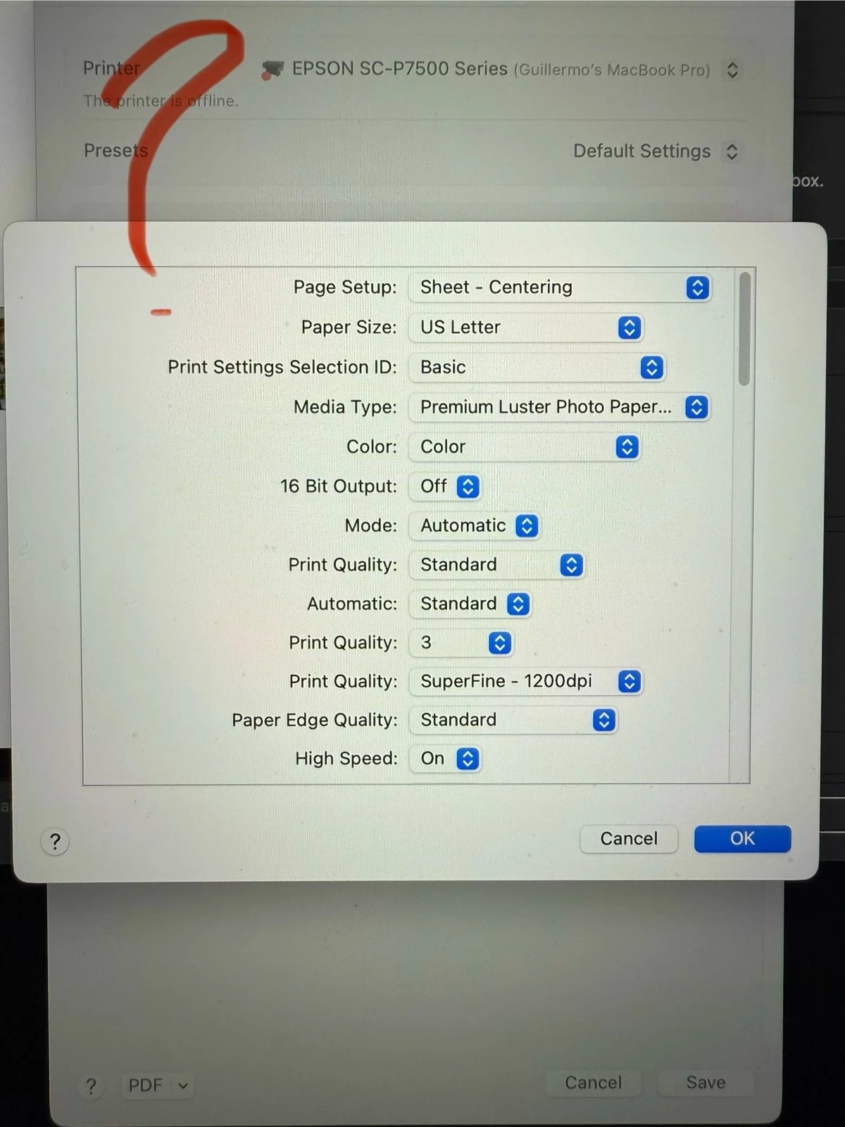

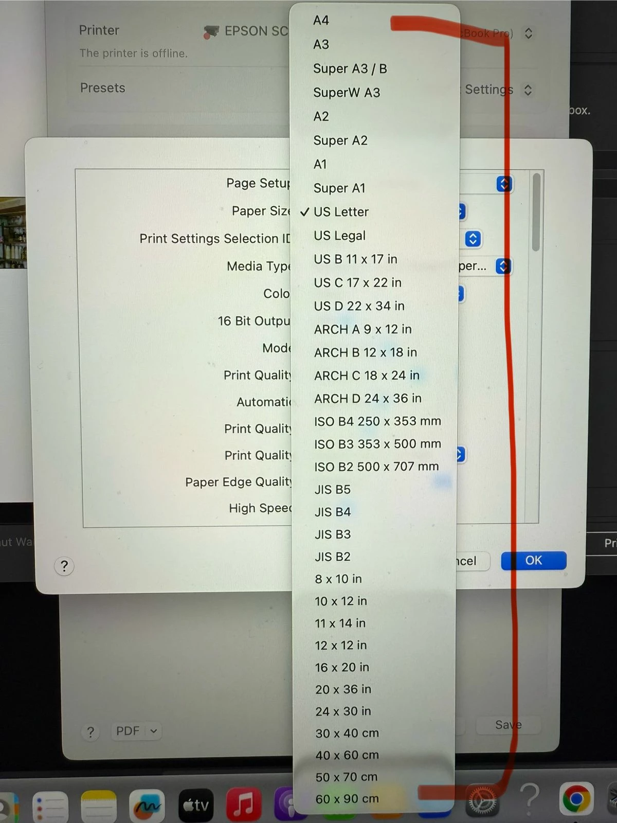

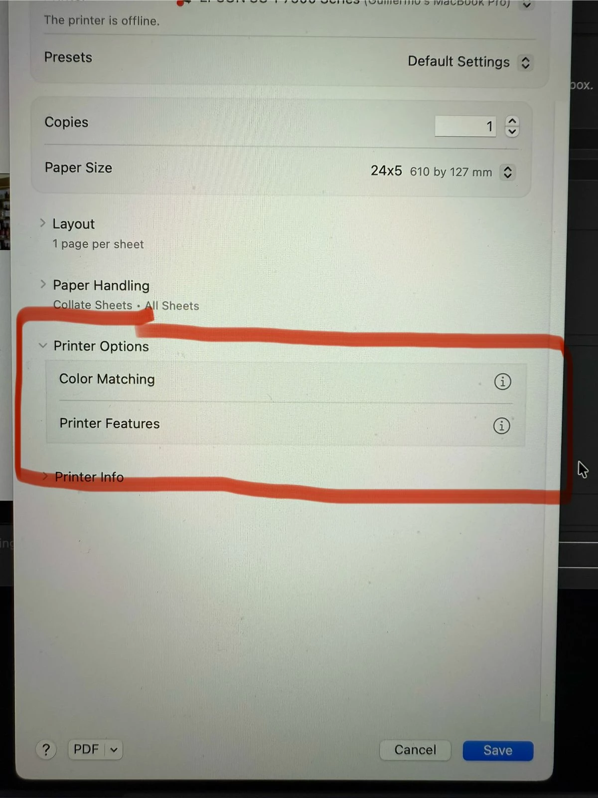

The options shown in the screen shots are more basic, so it looks a lot like the perennial problem where the Mac is using the basic default Epson printer driver software installed by macOS (it may appear as an “AirPrint” driver), and not the full professional Epson driver that shows all features and profiles.
The traditional way to fix this is to go to the Epson web site, download the latest available Epson driver installer for your specific printer model and version of macOS, and run that installer.

Nov 3, 2025 7:26 PM UTC
That's not the Epson driver, that's a generic MacOS driver.
Reinstall again.
