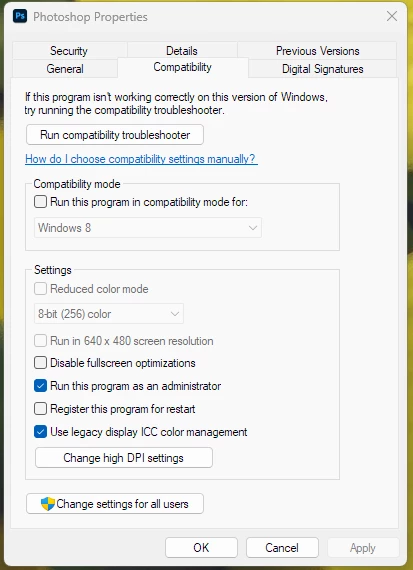

hello,
I have a problem with my Photoshop, it is not showing the home screen or even my account photo or saving files to the cloud when it is not in administrator mode, also I have Illustrator on my PC, and it works just fine, how can I solve this problem, so I do not have to run the program as administrator each time I use it
thanks

Thank you! I have the exact same problem, just as you described.
I’ve searched the community and the web, but the answer always seems to be to rename the UXP folder. However, this solution doesn’t work in this case. As you mentioned, the other Creative Cloud apps work fine without admin access.
I started Photoshop with administrator privileges and the problem was solved. Thanks again.
