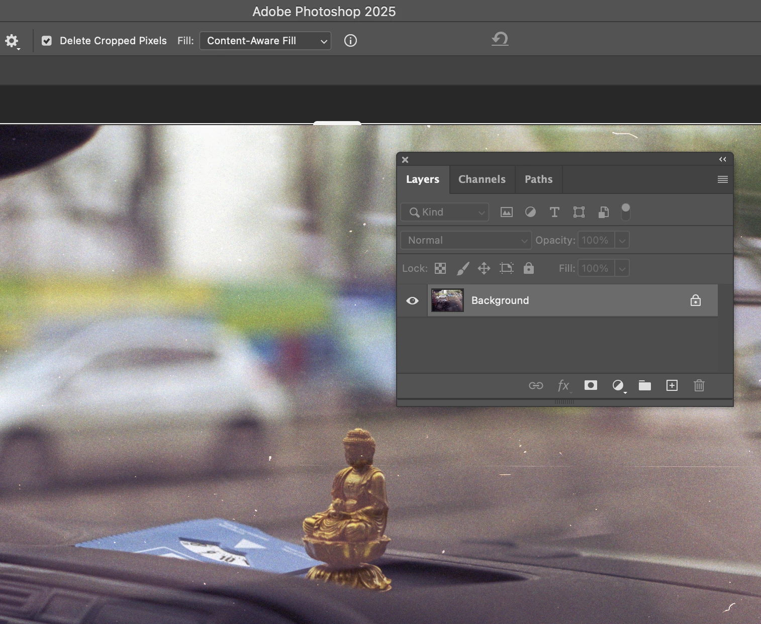

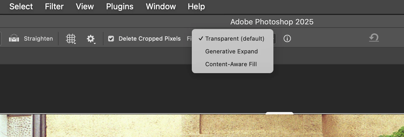

One instance where it changes away from the manually-set "Content-Aware Fill" is when I open a file with more than one layer (background layer being locked by default).
The problem is the fill mode then changes to "Background (default) for all open files, and all files I open from there on out.
The only "solution" to set it back to "Contant-Aware" is to quit PS, open it again without a file, set crop tool, set "Content-Aware Fill", close PS, open it again..
Also it doesn't seem to make sense in the first place as to why the fill mode changes - when opening a single-layer file (with locked background) it will happily stay with "Content-Aware" - see attached screenshots..
