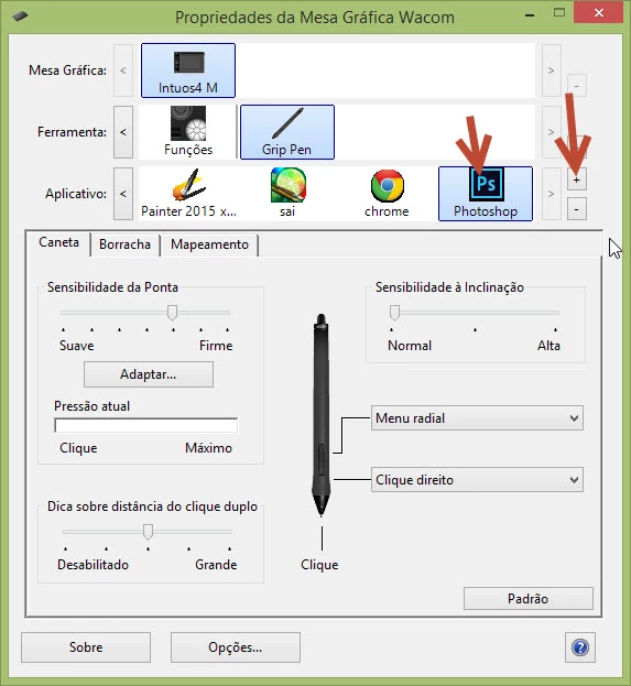

Dec 18, 2014 12:40 AM UTC
I solved this problem adding the application in wacom control panel.
Jan 27, 2015 5:12 PM UTC
