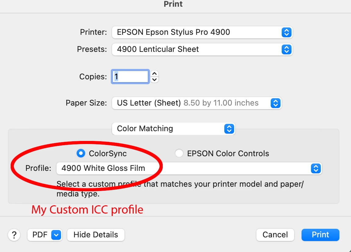

I found a work around that does work with color files - manage color in the Epson driver instead of the Photoshop print dialog. In the Epson driver select ColorSync and your custom profile. Hopefully Apple & Adobe can get this fixed.
December 22, 2021
I have the exact same problem although I'm using an Epson 4900. I can print from Affinty Photo and Microsoft Word just fine, but not from Photoshop. Like you I deleted and reloaded both Photoshop and the Epson driver. I found a "band aid" work around, but not a solution. In the Photoshop Print Settings Dialog Box, pick Printer Manages Color. Then hit the print button. In Print settings, under Color Matching, choose ColorSync. In that same window, use the drop down to choose your profile.
I'm not sure if this is an Apple, Adobe, or Epson issue, but something has changed with the last OS update.
