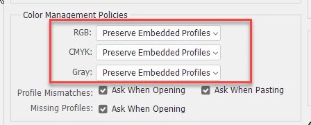

In colour settings make sure you have these checked
That will make sure that Photoshop uses the colour profile embeded in your document
When printing use File > Print and select "Photoshop manages Colours" and the correct Profile for your printer and paper combination
In your printer - make sure colour management is off and that the paper settings are as advised by your paper manufacturer
That is it. Nothing to convert - colour management is simple if you let it do it's job. You only need the Adobe Colour Print Utility if you make your own profiles.

    If Photoshop is set to Preserve embedded profiles – it will use the colour profile within the document.
