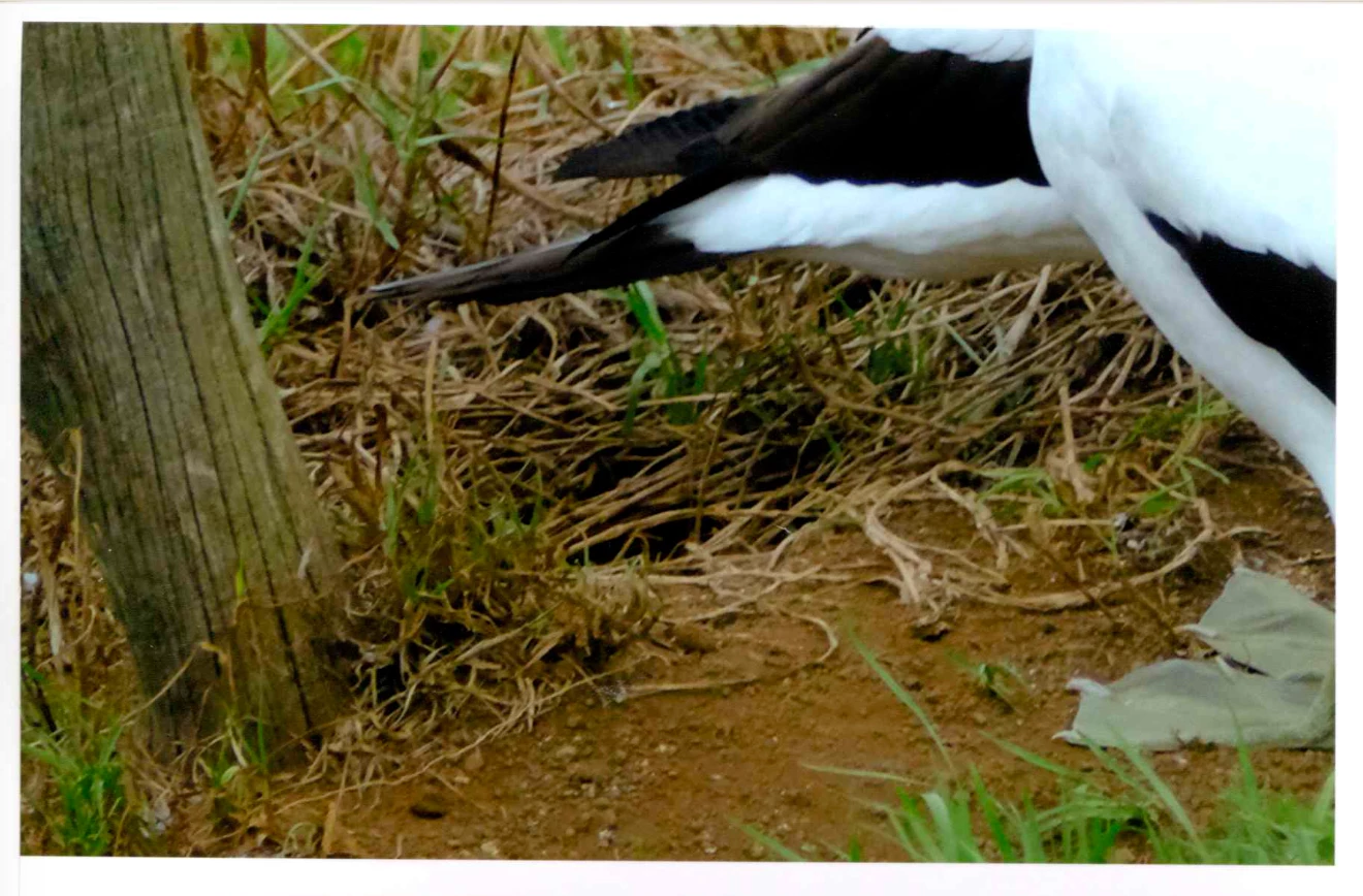

I have recently experienced an issue when I try to print an image which has been cropped to 10x15cm from A4.

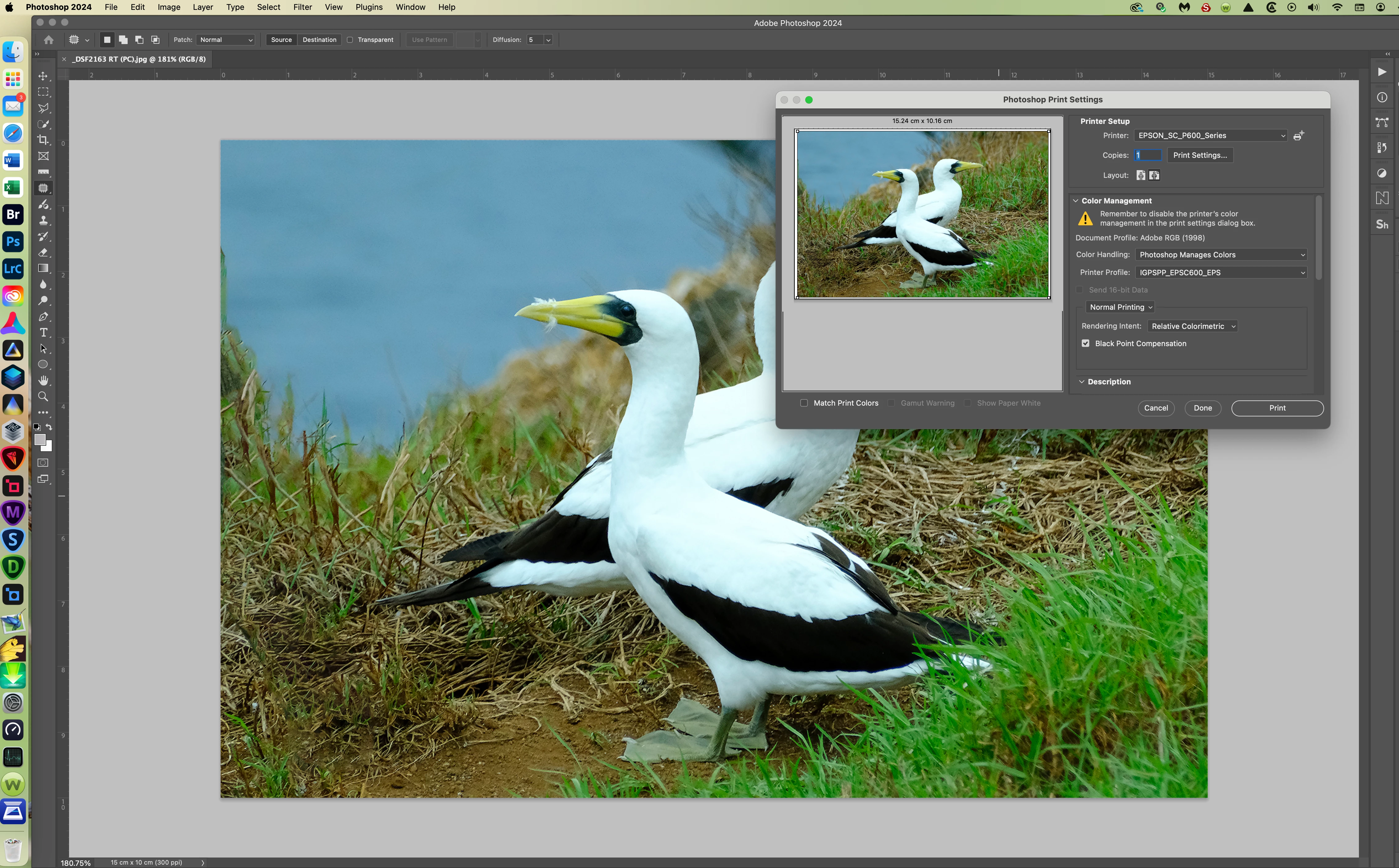

All the settings in the Photoshop print dialogue shop the correct 10x15cm, but the image on my 10x15 paper is only approximately one quarter of the subject and of a size which appears as though the printer is trying to print A4.

I deleted the Settings File in Photoshop and checked all my preferences.
Everything is now working correctly
