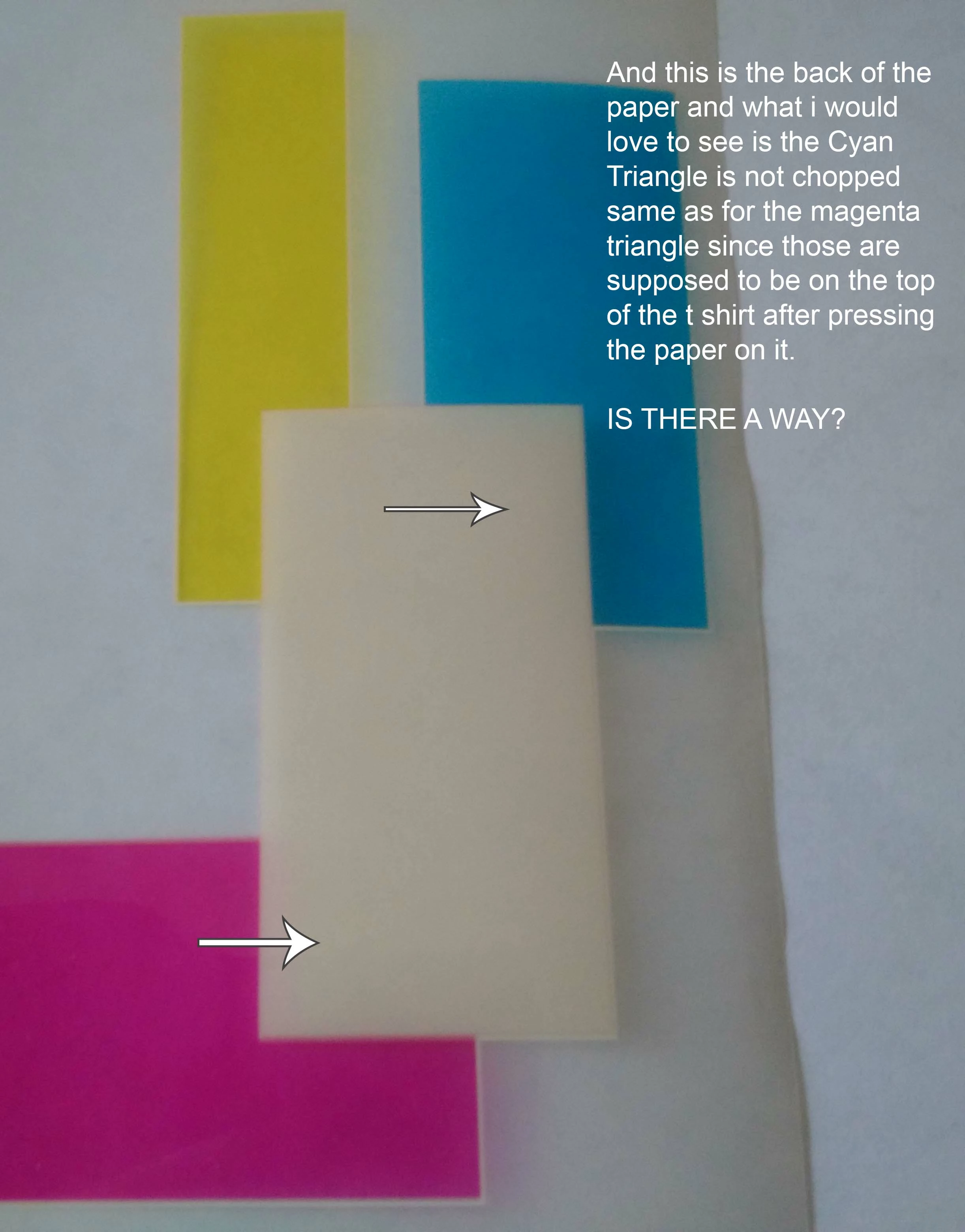

    Hi
    The simple answer to your question is no.
    In photoshop your image is broken down to individual pixels. Each pixel has one colour which is arrived at as a result of all the layers and blending modes. Therefore for each pixel only one colour is sent to the printer (well actually a mix of channel colours to make up that one pixel colour). An inkjet can only print one colour at that pixel location in one pass.
    Therefore you cannot do one printing pass and have it look one way from one side of a transparent sheet and another way from another side of the same sheet. The only way to achieve that, using photoshop and an an inkjet printer is multiple passes.
    Dave

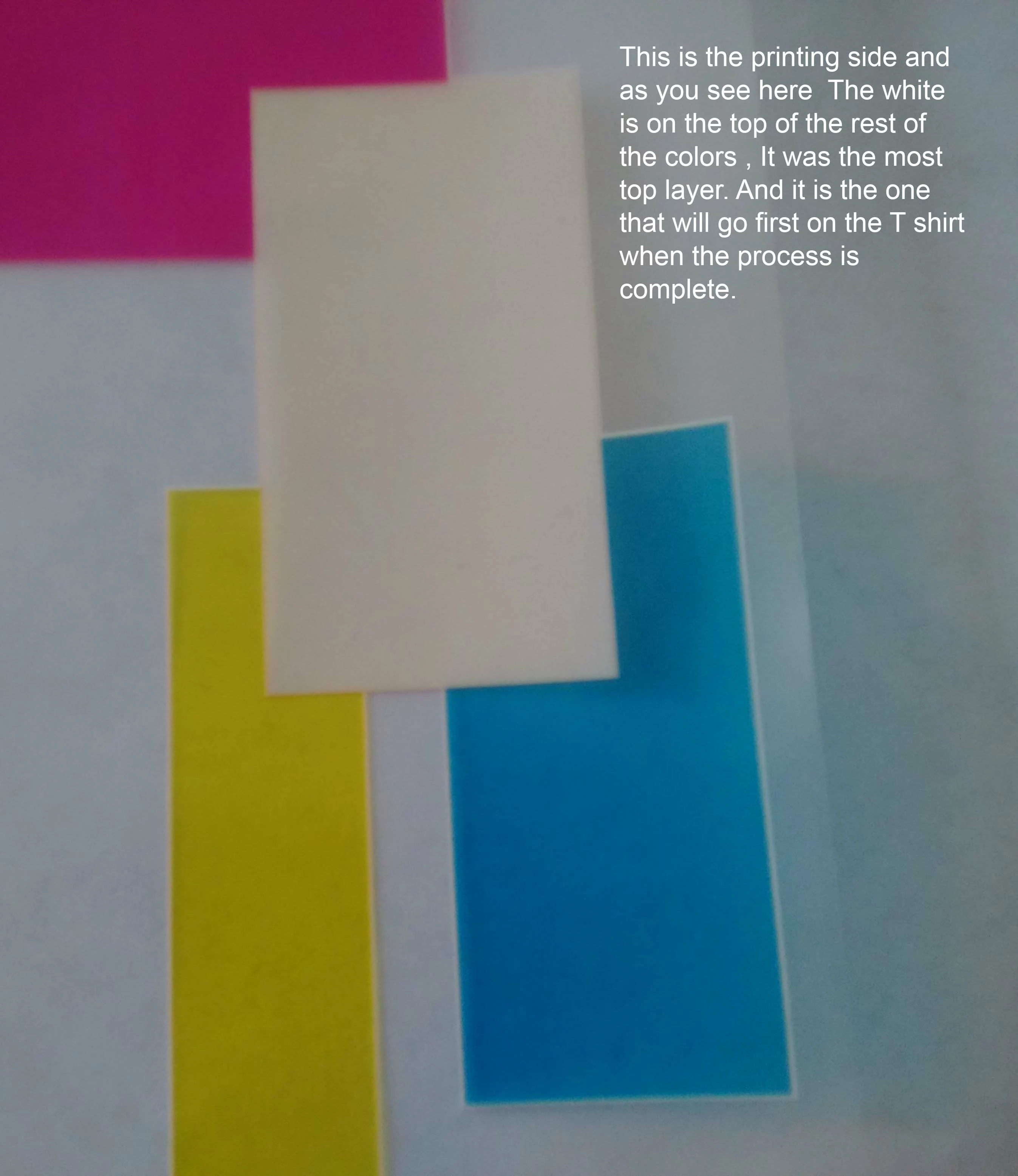

    testarosaAuthor
    August 11, 2018
    I want to maintain the colors and shape, is there any way to do that?
    reason for that is am printing on transparent layer to press it on a tshirt
    I need the bottom layer on the transparent layer to be on top when laying it on t shirt
    so in my example the magenta will be on the shirt and on top of it the cyan.
    I have to find a way to not alter the cyan (if there is) without running the paper through the printer twice, once to print cyan circle and second pass to print the magenta circle on top of it.
    I hope there is a workaround because I could not have a remedy from the printer's driver and settings, it is set in stones there.
