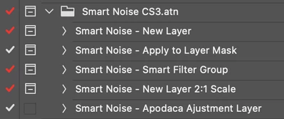

Stephen Marsh
Sep 2, 2025 1:47 PM UTC
Noise has too be evaluated at 100% view (1:1), where 1 image pixel = 1 monitor pixel.
i generally use overlay or soft light blend modes for "smart nose" - I'd need to test.
I use actions for this::
https://www.dropbox.com/s/5rmz0b6c7a40h7y/Smart%20Noise%20CS3.atn
