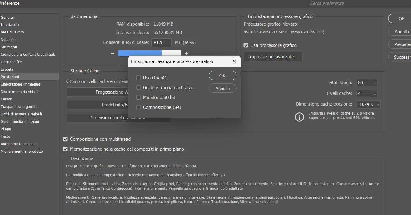

    Hi! Yes the RTX5050 card has 8 GB video RAM.
    The graphics processor box is checked, but nothing is selected in the advanced settings because I wouldn’t know what to select.

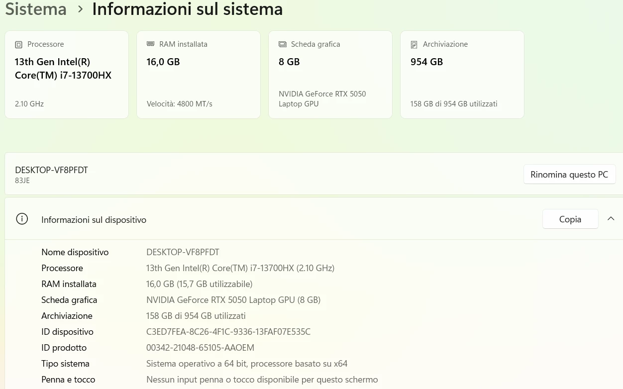

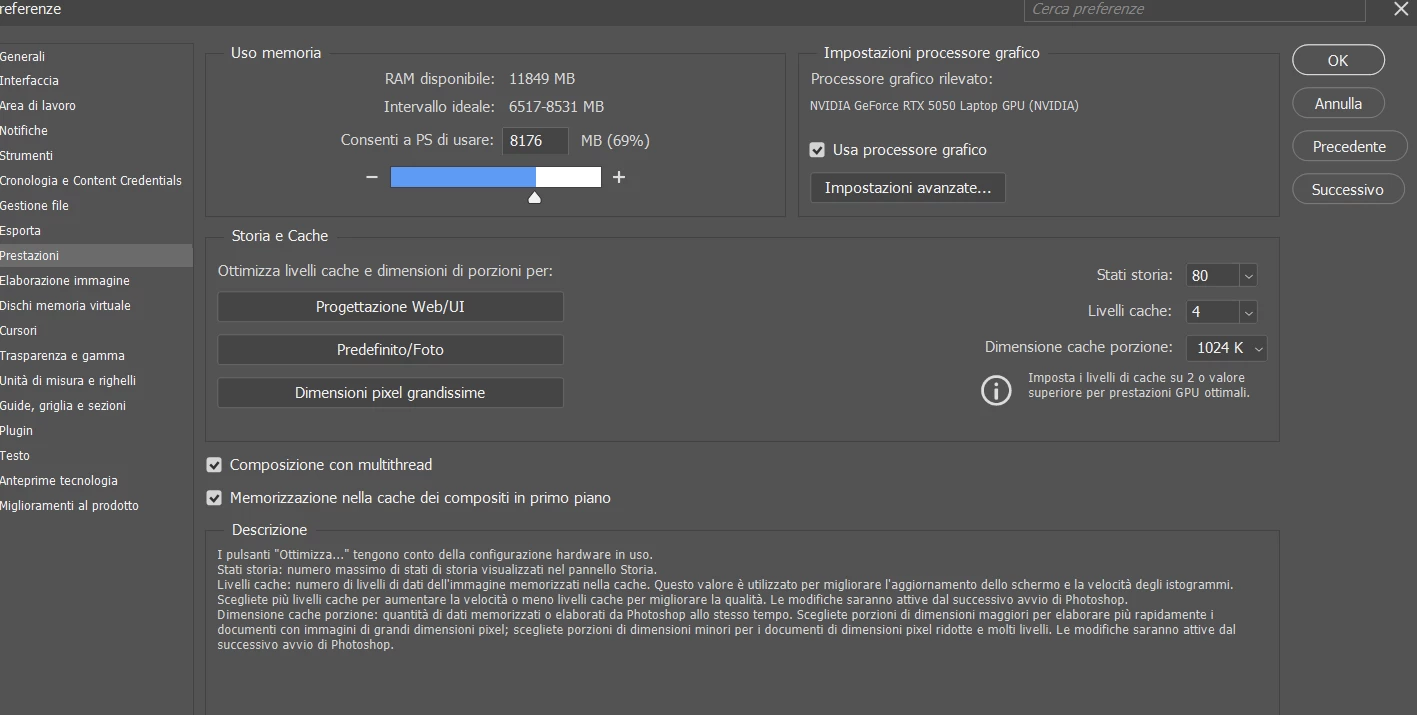

    Available RAM: 11849 MB — Ideal range: 6517–8531 MB — Let Photoshop use: 8176 MB ( picture attached but in Italian.. I am sorry).
    My camera is Canon  5d mark IV. I ’ve never had these kinds of problems before, even with much older computers. The issue only happens with Camera Raw when I start using preset filters.
    Thank you for your help.

    ilaria_6345
    May 19, 2026 6:55 AM UTC
    Hello!
    The problem in ACR starts especially when I begin using filters, but sometimes even with simple basic adjustments.
    Unfortunately, I’m not very good with this kind of thing. The problem has been going on since November 2025, when I bought the laptop. My laptop support says the issue is related to Adobe, but Lenovo support says the issue is related to Adobe. I don’t know what to do anymore.
    As I write to ​@LAMY2017,  I haven’t selected anything in the advanced Grapchic Processor settings because I wouldn’t know what to select.
    Pciture of System Info attached… and also picture about RAM used by PS.
    D Fosse
    May 19, 2026 6:31 PM UTC
    What we need is the complete system info from Photoshop. Go to the Help menu > System Info. Copy the whole thing and either paste it into a reply here, or paste it into an attached text document. Yes, it’s very long, that’s the whole purpose. It has all the details.
    On thing I notice right away, though, is that you have history states set to 80. That’s extremely high and can easily be a problem in itself. Each one of those history states potentially adds the full nominal file size, multiplied by number of open files. That’s a mouthful of data, and it has to be stored somewhere. So it goes to disk.
    I would recommend 20 history states max.
    In Photoshop Preferences > Performance > Advanced, check all the boxes except 30 bit display - unless you actually have one. But OpenCL, anti-alias and GPU compositing should normally be checked.
    Reset Camera Raw preferences by holding ctrl as you click Edit > Preferences > Camera Raw. This is separate from Photoshop preferences. You’ll get a confirmation dialog.
    Now - my prime suspect is still the dual graphics configuration. Normally, it shouldn’t be necessary to do this in the BIOS. The recommended way is to disable it in Windows Device Manager. Maybe, just maybe, doing changes in the BIOS can mess up something else. It’s always safest to leave the BIOS at all default settings.
