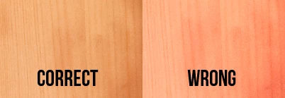

I have an image in Photoshop (CS5, Windows 7) which I wanted to export to PDF in order to print it but then I noticed that the colors varied significantly making the result unusable.
The image is composed in AdobeRGB and I'm working on a wide gamut monitor (Dell U2711) which I calibrated and profiled with a Spyder4.
In Photoshop the image contains a nice dull light brown but when I open the PSD in Illustator or InDesign or when I export it to PDF and view it in Acrobat there is way too much red in it. Below I have attached an example of how colors look like in Photoshop (left) and the rest of the system (right):
(note: this is an AdobeRGB JPEG, so viewing it on a normal gamut monitor might not show as much difference as there actually is)
This color mismatch is very extreme and I don't know what's causing the problems. I tried different profiles for my monitor (the one I created with the Spyder, the factory profile from Dell, the standard AdobeRGB profile, no profile at all etc.). While the color obviously changed a little the overall problem still persists: Photoshop shows the nice yellowish brown, all the other applications show a very reddish image. The difference is even noticeable quite extremely on my second monitor which is just a normal gamut monitor with a color range of about 73% of sRGB.
I also tried exporting it to a flat JPEG with no embedded profiles which makes the result a little better but the colors are still not accurate at all. This is very confusing as I don't know what the problem is and I also don't know if it's just Photoshop displaying wrong colors or if all the other applications just do bad color management.
It would be great if you could help me here.

    Did you make that last test using Illustrator too? So far from all you said it appears that the monitor profile is OK because Windows Explorer, Photo Viewer, and Bridge are using the same monitor profile like Photoshop, but Illustrator, InDesign, and Acrobat may be are using your laptop screen color profile confusing it for u2711. That's why I'm asking you to remove your laptop color profile to force and make sure all programs are using the same monitor profile.
    If it's not the right profile, there would be at least two independent even more wrong profiles which I switch by assinging the right and wrong profiles. I doubt it. I'm pretty sure Windows and Photoshop are using the right profiles. Both monitors change independently when assinging different profiles and the colors in Photoshop always change accordingly.
    The applications which don't seem to choose the correct profile are Illustrator, InDesign and Acrobat. When I make the external monitor the primary one they display the colors correctly. But as soon as I make the notebook monitor the main display the colors are wrong again.
    So I suppose Windows and Photoshop are doing everything right, but Illustrator, InDesign and Acrobat are only using the profile of the primary display. So when viewed on the wide gamut monitor it's all clearly oversaturated (especially in the reds). However, when I set the wide gamut monitor as my main display they use that profile for both resulting in accurate colors on the big monitor and also quite accurate colors on the internal monitor because it's color range is much smaller.
    I would declare this a bug in those applications.
