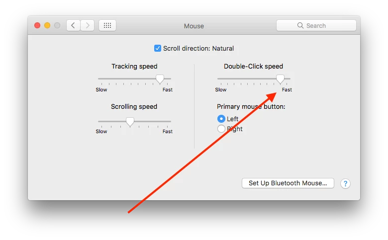

ProdigyShane
Feb 14, 2017 10:26 PM UTC
ALERT! ALERT! I found a solution to the double-clicking / window selection and movement problem!
All I had to do was to adjust my mouse double-click speed in system preferences to the second-from the right. You have to actually adjust the MOUSE double-click speed, not the Wacom pen double-click speed.
4 months later and I can finally use my Intuos tablet again. Halle-freaking-lujah.

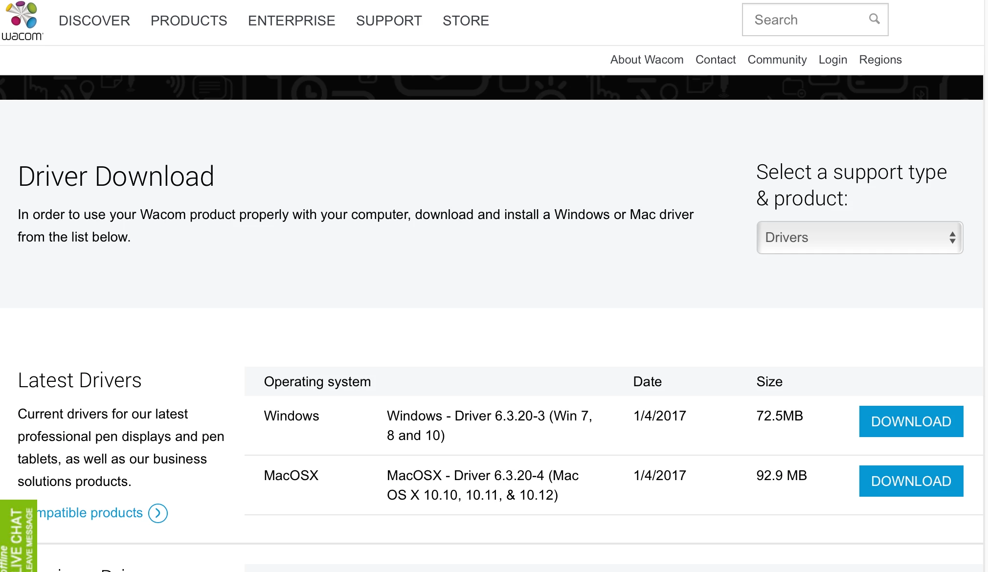

Jan 15, 2017 1:40 AM UTC
They also put up a new driver that fixes these issues with the short cut keys (ALT, Shift, & etc.) Here's the link:
Drivers | Wacom
It's the one that was put up on 1/04/17
