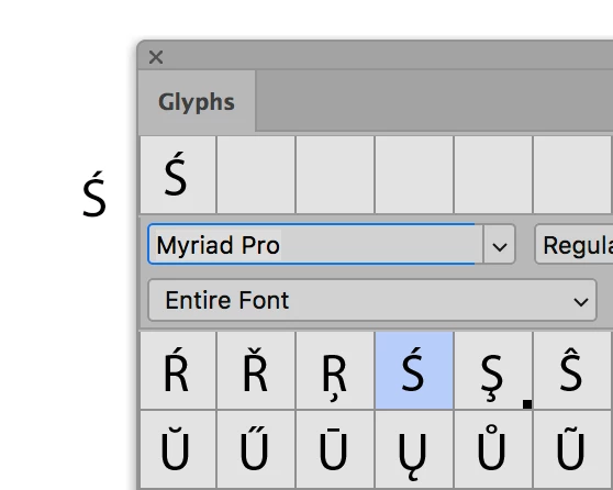

Hi
One way is to use the Glyphs panel from the Window menu until you get it sorted. It will remain in the Recents at the top once you find it.
