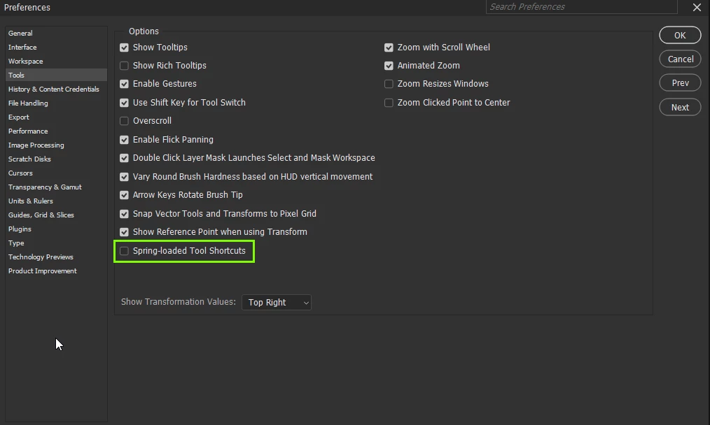

julian_LVAuthor
January 23, 2025
After a full day of switching tools it seems to be working ! I changed the timer of the setting you pointed out to a longer time.
Thanks again
julian_LVAuthor
January 22, 2025
Thanks, I didn't know about this setting, on mine there's a timer setting, I'm going to try changing the timer and switching the setting off. I'll let you know.
Ged_Traynor
January 22, 2025
@julian_LV have you tried disabling this option in preferences to see if it helps
