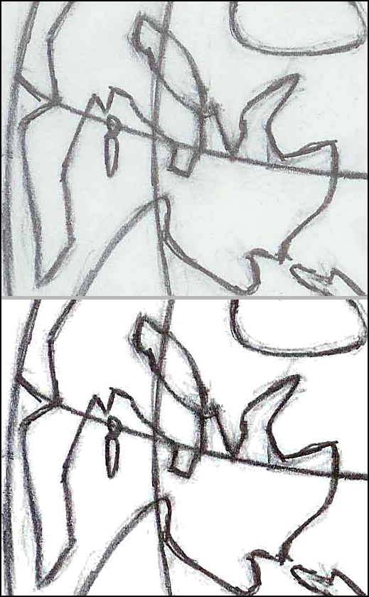

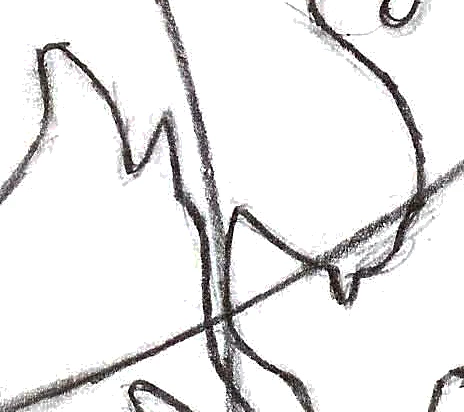

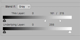

    In order to judge your work you might  check it at 100% of size. At that setting, this is your result:
    Using the Blend If command can clean up much of the (I assume) unwanted tone, maintain the character of the pencil texture and avoid a heavy-handed effect, will take you this far. The balance will require brushwork.

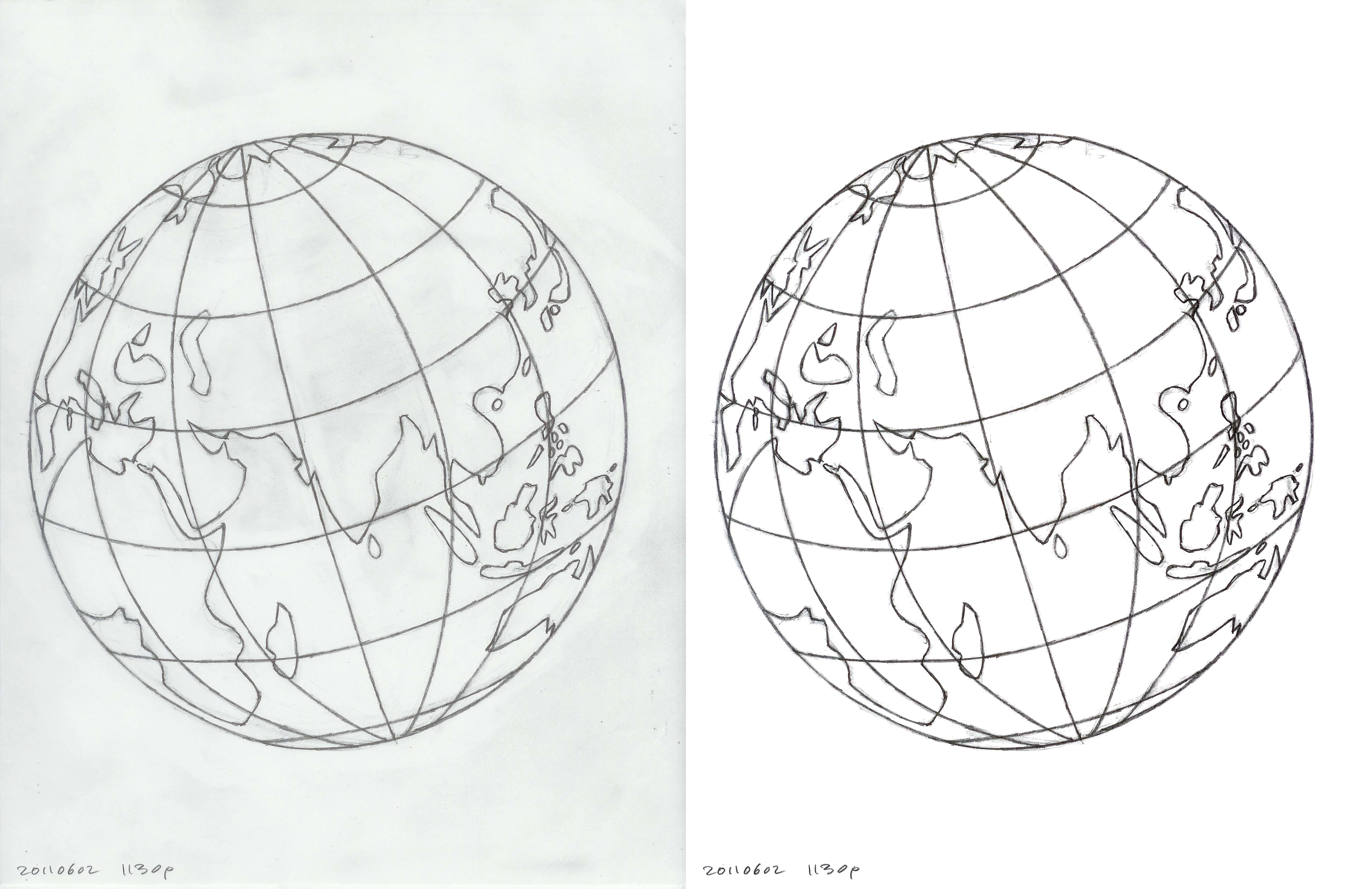

    Here is an example to the suggested idea.
    I took the image from Smoothing out rough lines? (Details in post)​ by chewingcow​.
    This is the result:
    What do you think about this result?
    Could anyone share another image to test and compare to Photoshop?

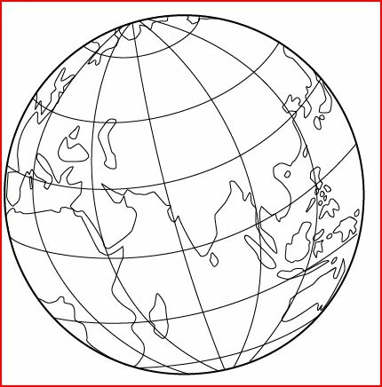

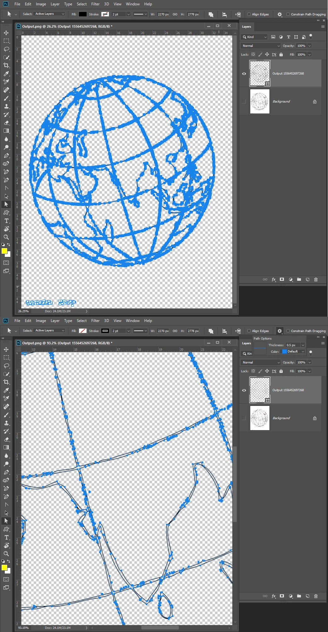

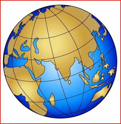

    I see a lot of dialog example ideas and different results in the thread you posted a link to. Mainly about creating vector shapes. Though no vectors files were posted. Vectorizing that image is a much better ]approach then your raster png file.  Which could use a lot more cleaning when you look ate you png file actual pixels.
    Perhaps you should try to revive that thread.  A vector version will be much cleaner and can be scaled to any size you need.  Only small scaled down versions were posted in that thread,
    A cleansed up raster version may might to be traces with a program and have good paths created.   Your png will not be traced well.
    clean image can be traced quite well
