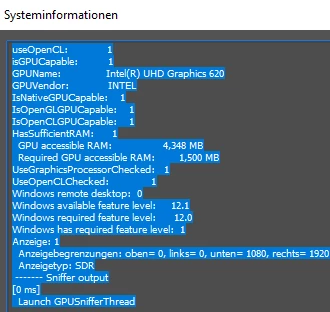

PS in current version 2023 under Windows 10 requires GPU acceleration when opening Camera RAW. Default setting in Camera Raw shows GPU Off because graphics acceleration is not supported by the system. PS accepted the GPU during installation, the driver is up to date. Error solution?

Note that ACR and Photoshop use the GPU independently from each other. ACR's requrements are actually quite a bit stricter nowadays, so it may well work in Photoshop but fail in ACR.

@Matthias34373342b2nw the Intel 620 is not really sufficient to run the most recent versions of Photoshop and Camera Raw, you really need a dedicated GPU
https://helpx.adobe.com/ie/camera-raw/system-requirements.html
https://helpx.adobe.com/ie/photoshop/system-requirements.html

@Matthias34373342b2nw what exact GPU do you have in your system, can you post your Photoshop system info, in Photoshop go to Help > System Info, hit the copy button and paste the entire thing into this thread
