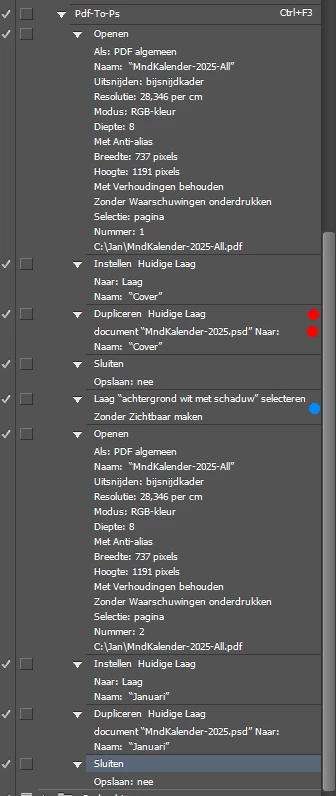

Have 2 documents:
nr-1 input PDF-doc with 12 kalender pages in it
nr-2 output PS-doc with a few layers in it (before start action)
Wanted:
Automated action.
Each PDF page wanted in a PS-layer
For example:
PDF-page -01  >>> PS-Layer-01: Januari
PDF-page-02  >>> PS-Layer-02: Februari
...and so forth...
If I do that manually, it works fine.
If I record an action, it works fine, ... if I run it, it fails. The correct PDF-page-nr is chosen each time (I can see it in recorded action). But only the FIRST month (PDF-gage 1) is visible in te PS-document and the action creates only 1 layer. How solve this problem?
And also naming the layers fails, but thats may be inherent the problem above?
jan99x
jan99xCorrect answer
Nov 5, 2024 7:44 PM UTC
@jane-e Jane,
In the meantime I have found a solution.
I suspect the problem was with "drag-drop" from docA (source) to docB (target) (I dragged in the image window). In that case, creating a new layer does not work correctly in docB (it is overwritten every time). This works correctly when recording, but when running the action it does not work correctly.
solution: If I right-click on the layer in source docA and select copy layer with destination docB, it works fine.
DocA = PDF > convert to PS (one kalender page)
DocB =Ps >> month's in every layer
Example image below:
Red = copy command in layer
Blue = select one layer lower for correct month order
Thanks any way!
Jan
By @jan99x
Can you share the steps in your action so we can see what you have?
If I were doing it, I would open the PDF in Adobe Acrobat Pro and export each page to a separate image. Then I would combine the twelve images in Photoshop using File menu > Scripts > Load Files into Stack.
You've tagged your post for Scripting, so the brilliant scripters will see it.
Jane

jan99xAuthorCorrect answer
@jane-e Jane,
Thanks any way!
Jan
jane-e
Nov 5, 2024 8:51 PM UTC
@jan99x
That makes sense! I've marked your answer correct and thank you for sharing!
Jane
