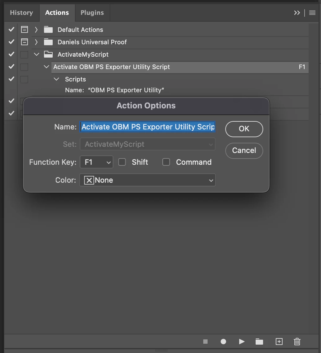

Once you have the script working you can create/record an Action of the process of you going to the file menu/Scripts/Browse/D:/Temp/Script.
Then you can assign a Function key to trigger the script, this will allow you to just activate Photoshop and hit the assigned Function key and the script will run.
