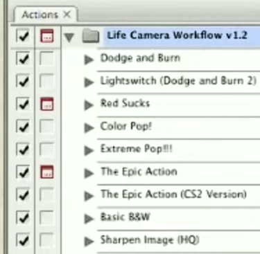

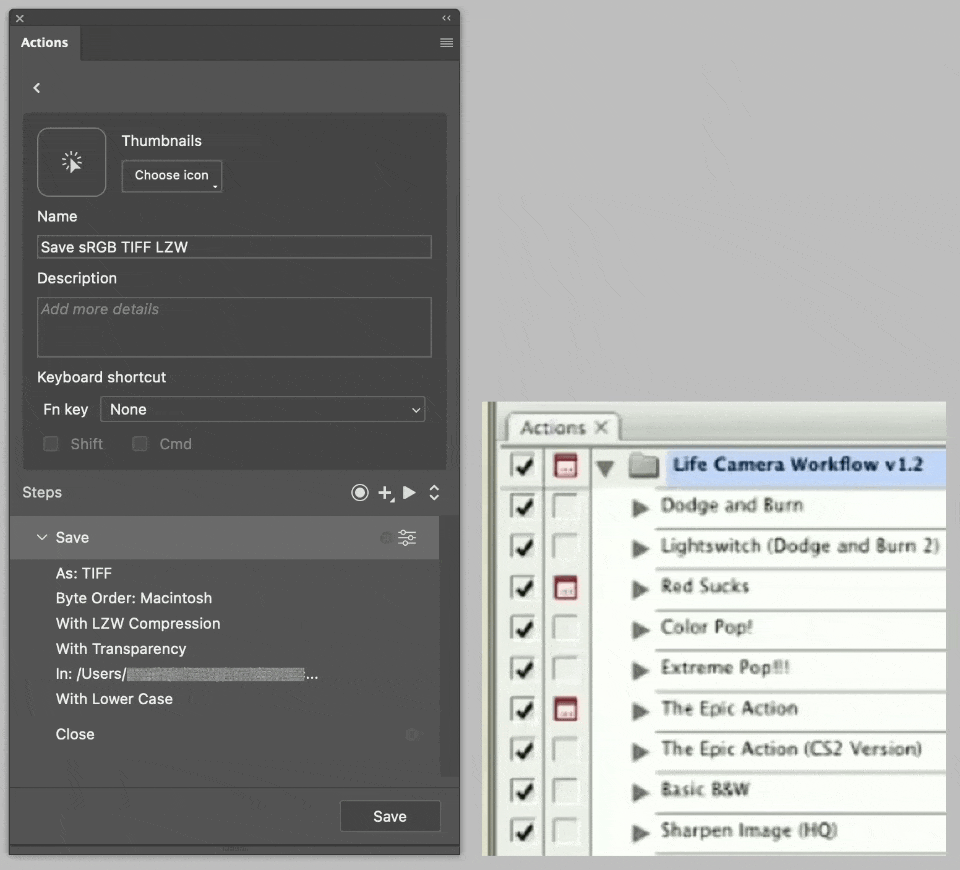

    However, in previous versions of PS a stop was NOT a sperate step … it was just a checkmark besides a step.
    My actions were created years ago and a stop is still there but NOT as a separate step.
    So, in other word:
    In my action I have no step called stop, but the action stops every time at save and asks where and at what quality level.
    Screenshots: my current steps / save … old version of stop checkmarks
    PS: I had some success using the pause icon :  “Override actions Save As commands”. Maybe Pause is what is meant?? When this is unchecked, the location designated in Bridge Batch works … without stopping every time.

    Oh, I see. Those are three different things, then:
    • Stop: Displays a dialog box with text instructions entered by the action maker (does not display settings).
    • Check mark: Unchecking it skips that step when the action is run. Does not control any settings.
    • Show Dialog Box During Action Playback: Pauses the action to let you enter options for a feature that offers a dialog box.
    It sounds like you want the one represented by the small, round button in the demo below, the one labeled Show Dialog Box During Action Playback in this old vs new comparison:

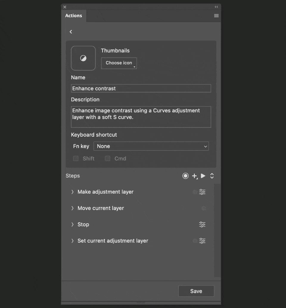

    Then what in Edit Action? I see the steps of the action > I see the step “save” … but no way to eliminate a stop in that step.
    The are “save”, “toggle step” “show dialog”, “edit recorded value”
    Only “Add a stop” … nothing to delete an existing stop
    Can you please be more specific.

    c.pfaffenbichler
    Aug 18, 2026 3:57 PM UTC
    So you are not actually talking about a »Stop« but a »Save As«?
    If you are talking about a »Stop« you need not delete it, you can uncheck it.
    Please post meaningful screenshots.
    One can set a Destination Folder in the Batch-dialog and forego saving in the Action itself.

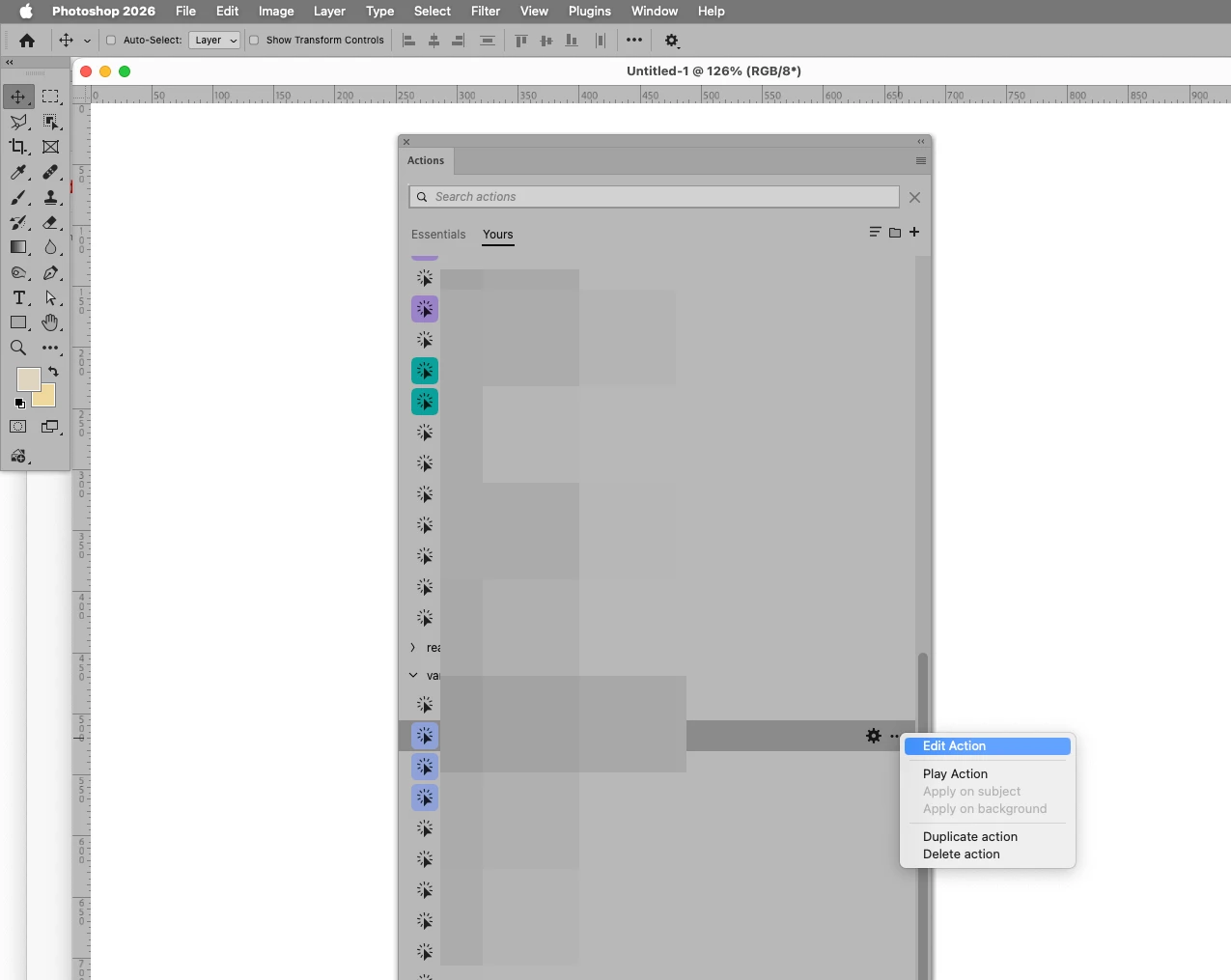

    c.pfaffenbichler
    Aug 18, 2026 3:25 PM UTC
    Edit Action
