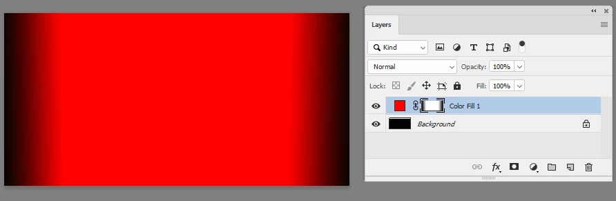

For smooth gradients use 16 bits/channel in your images
To make a reflected gradient - use this option in the options bar

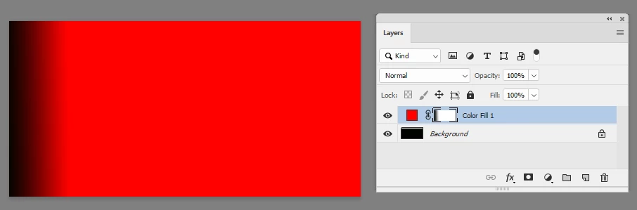

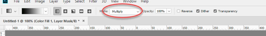

To apply a black and white gradient to two sides of the mask separately change the blend mode of the gradient to multiply. That way each side does not overwrite the last.

I can't figure out how you got that Multiply Gradient to work. It only does one side, even with Multiply picked and Black to White gradient.
I see you have a Color Fill Layer, but my image disappears if I do a Solid Color Layer.
Please post screenshots including the Options Bar, the Layers Panel and the Channels Panel.
Just to make sure: You are applying the Gradient in opposite directions?

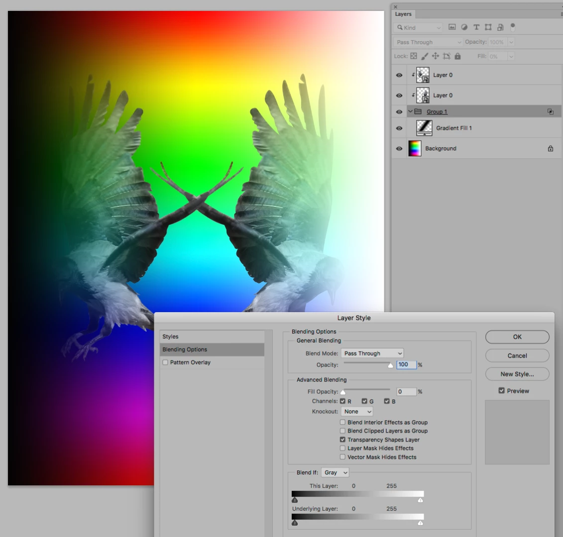

The gradient tool can do bi-directional gradients (as well as any number of other varieties). No need for two layers.
If banding is what you're complaining about ("lines showing up") - that's in your display system, not Photoshop, as long as you're working with 16 bit data. An 8 bit file  will always be susceptible to banding.

• Why don’t you use two instances of one Smart Object?
• And are you by any chance using »gradient« to signify »selection« or what do you mean by »do gradient with select and refine« exactly?
