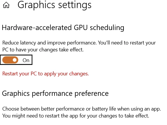

paulw12912733
November 17, 2021
Hi Jeff
I dont have a monitor attached to the laptop.
I have checked the settings we set the other day and they are still showing Ps and sniffer, but i have found this :
Does that mean i have to set those programs up in windows ?
It takes you to this:
Paul
November 17, 2021
It's weird because it looks like Photoshop is still using the Intel card. I'm really surprised that setting the NVIDIA card as the primary card didn't work. Are all your monitors plug-in into the NVIDIA card? or is one plugged into the integrated card?

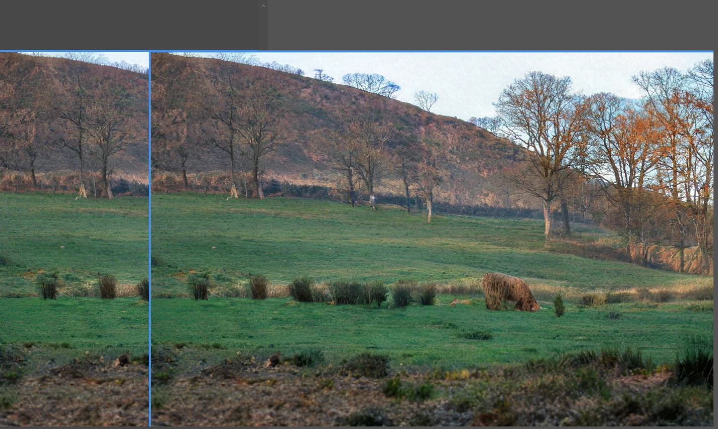

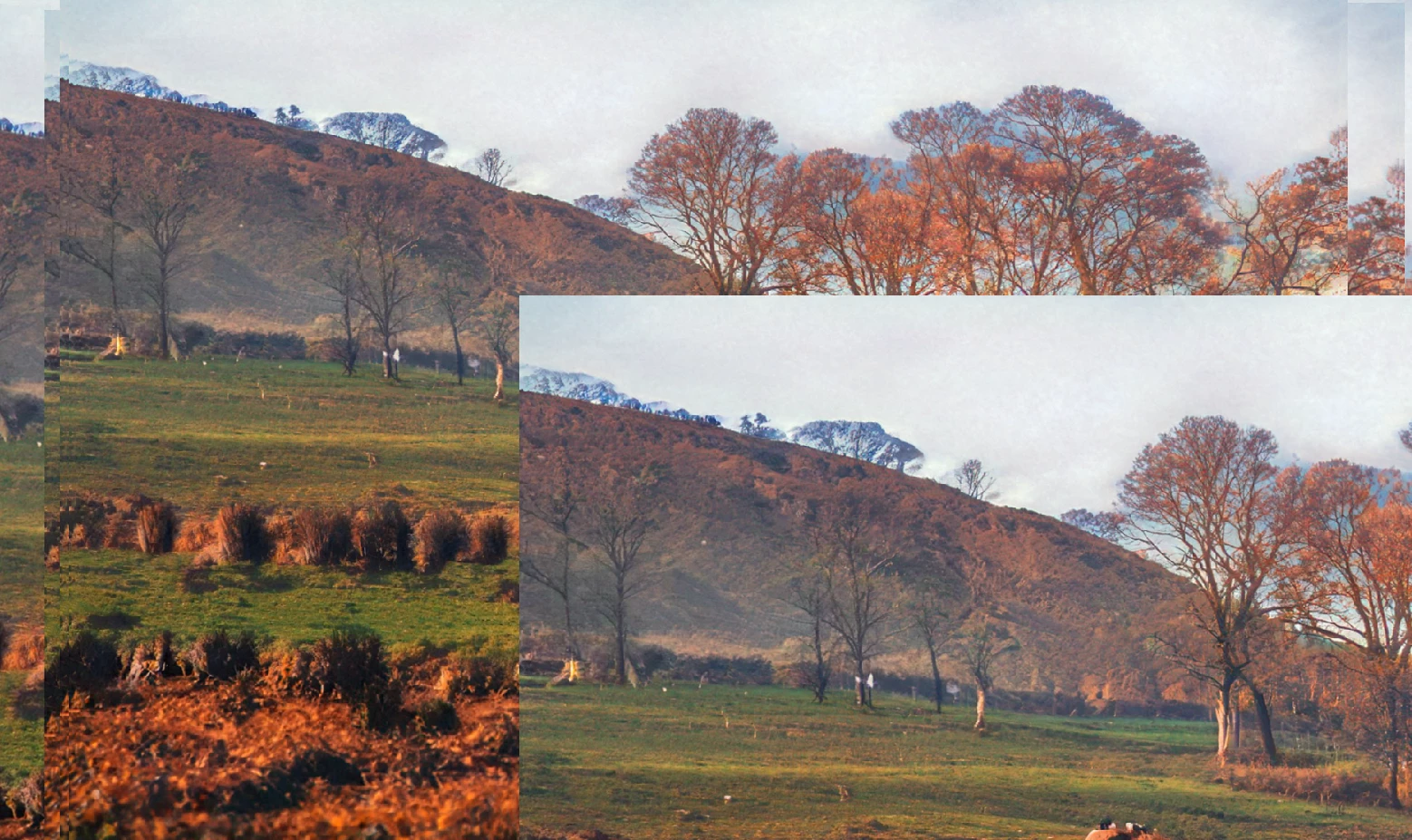

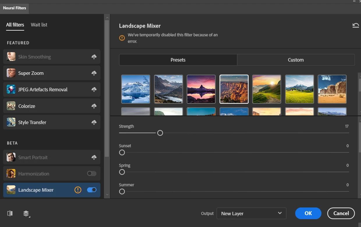

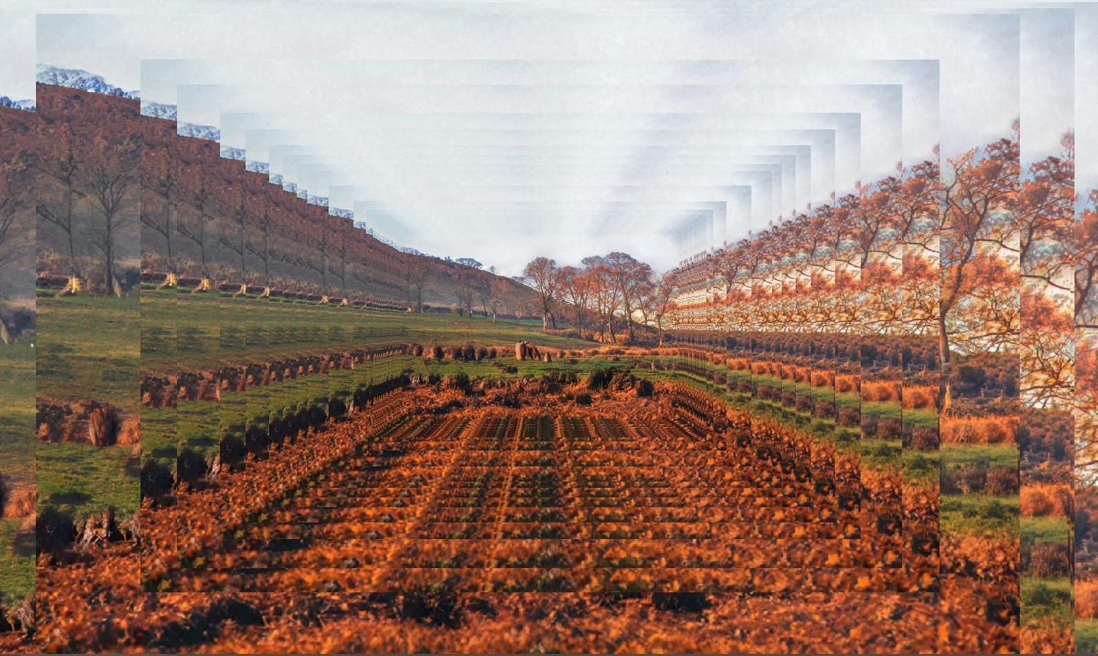

November 16, 2021
Hi Jeff
1st is the error message i get
2nd is the Image after click ok out of the neural filters panel
3rd is the image after trying to get it back to 100% on screen
4th is when i try and load the image back into CR filter
cheers
Paul

paulw12912733
November 16, 2021
Hi Jeff,
This has not resolved the issue. It tells me it has been temporary suspended due to an error
