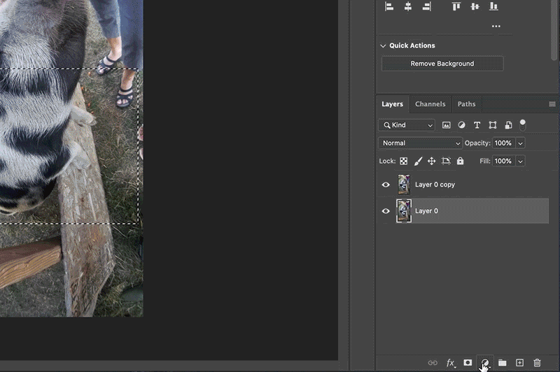

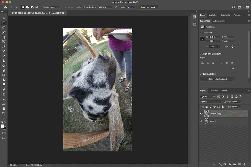

➊ Open the image and duplicate the background layer.
Tip: This is good non-destructive editing habit and will be useful later.

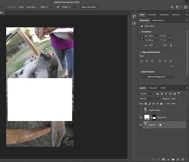

➋ Create a frame shape selection.
This will be the shape of the picture frame the subject will jump out from.
  • Use the rectangular marquee tool to create a frame shape selection.
    • Don’t worry. This shape can be adjusted later.
➌ Use a Solid Color layer to fill the selection.
  • Use a Solid Color adjustment layer to fill the marquee selection with white on its own layer.
Notice the bottom-most layer (Layer 0) is selected, which puts the new Solid Color layer (Color Fill 1) above Layer 0. Read more about adjustment layers here

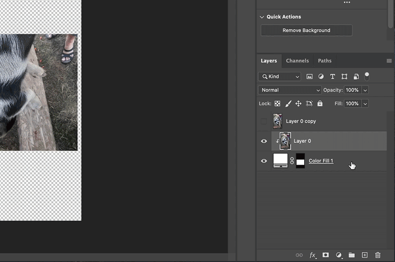

➍ Clip (alt/option + click) the photo layer to the frame shape we just created.

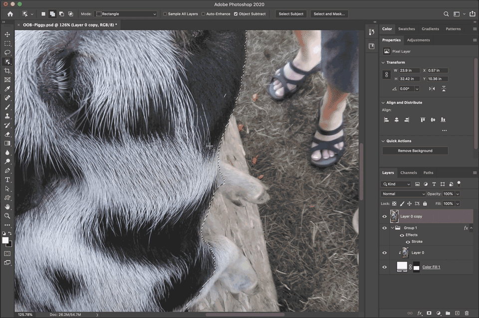

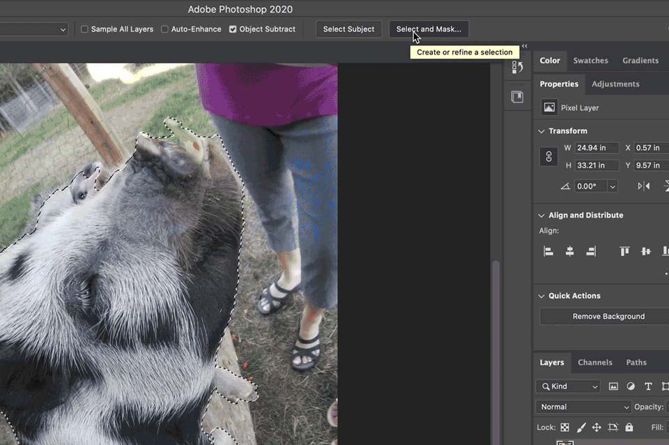

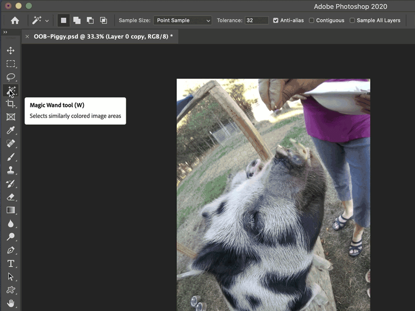

➏ Select the subject with the NEW Object Selection Tool.
Tip: Use Shift or Alt to add or subtract from the selection.

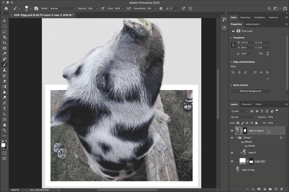

➐ Fine tune the mask!
  • Use Select and Mask.
Tip: Export the refined selection to a new layer with mask.

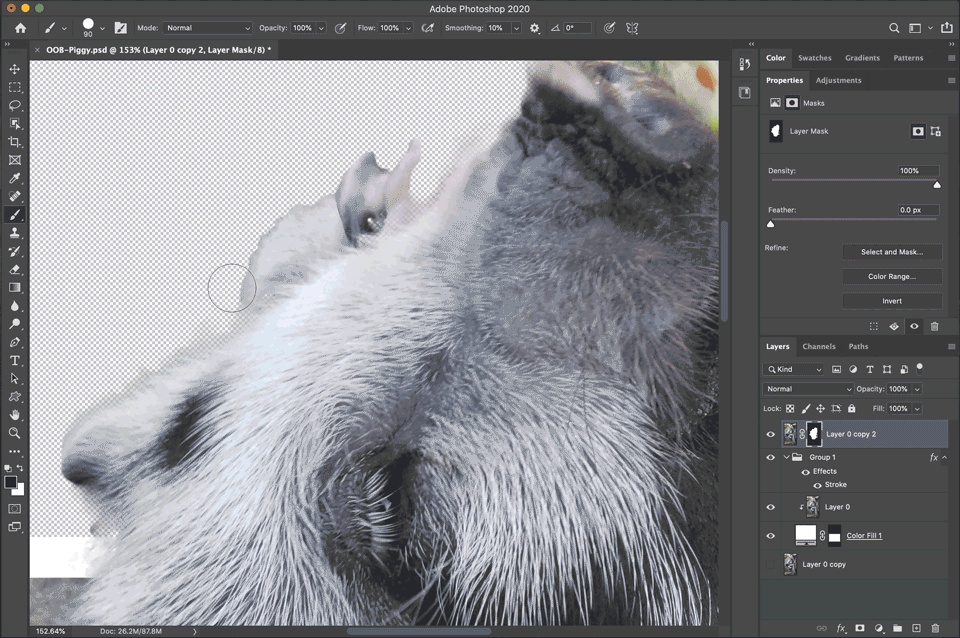

b. Refine the layer mask with the Brush tool. New to layer masks?
Remember: “Black conceals, white reveals”

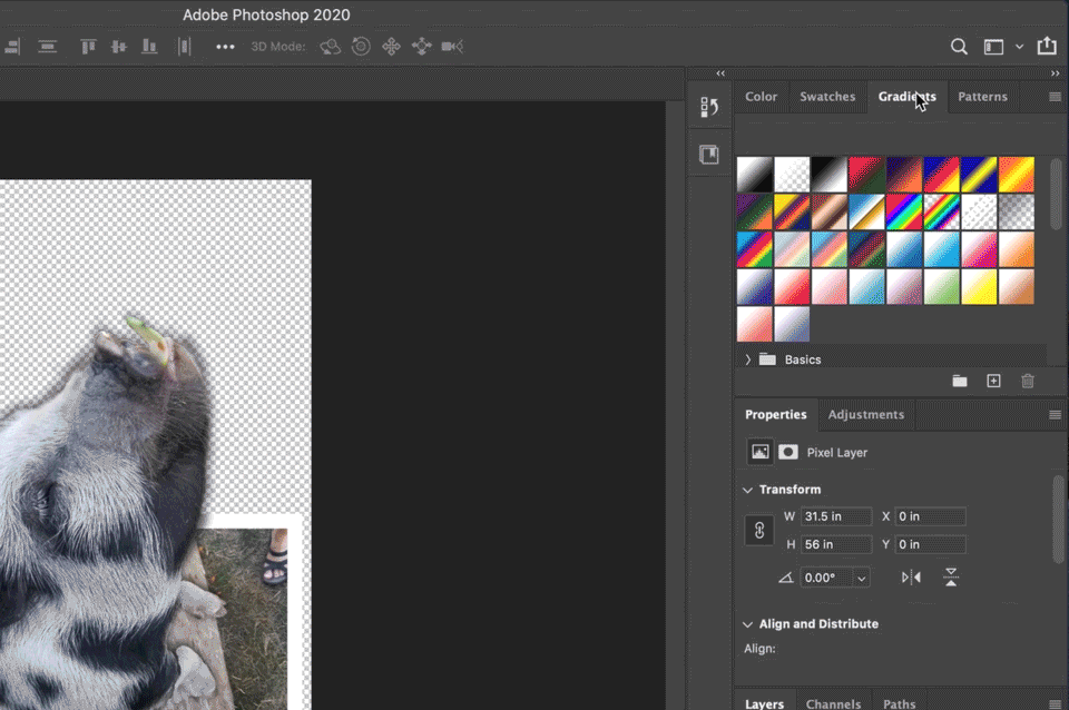

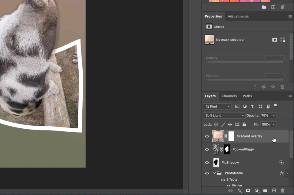

➒ Add a touch of color with NEW Gradient presets.
Tip: Selecting different presets will alter the same adjustment layer. Try them all!

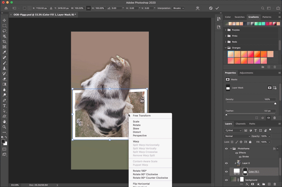

➓ Refine the frame’s shape with NEW Transform Warp.

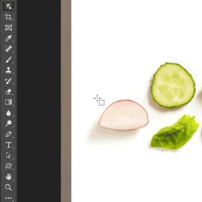

To give some context to this piggy image, I found some sliced vegetables on Adobe Stock and masked them into the image. The new Object Selection tool worked great!
