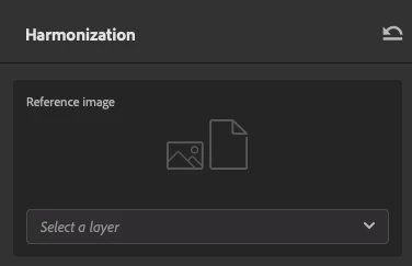

 Select the Harmonization filter
In the Beta filter list, select Harmonization.
Note: If this is the first time you have used the filter, you will need to download it  before selecting it by clicking on the download button in the right panel.
Pick the layer to harmonize with
Click on "Select a layer" and choose the background layer you want to harmonize with. (This is the one-click part)
