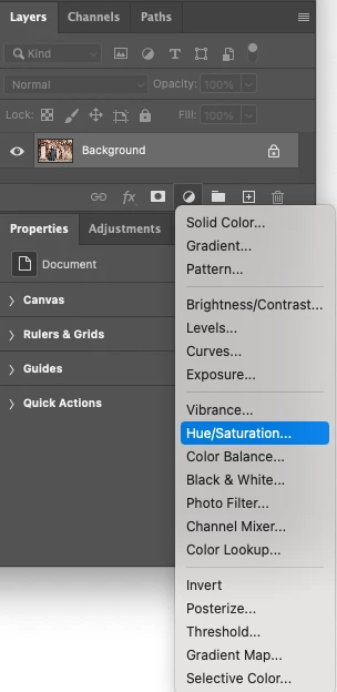

❶ Create a Hue/Saturation adjustment layer
Here are 3 different ways to create a Hue/Saturation Adjustment layer. You can choose one of these options:
-In the menu bar, choose Layer > New Adjustment Layer > Hue/Saturation and Click OK in the New Layer dialog box.
 -As an alternative, you can click the Hue/Saturation option from the Adjustments panel.
 -Or, from the Layers Panel, click the new adjustment layer icon and choose Hue/Saturation.
