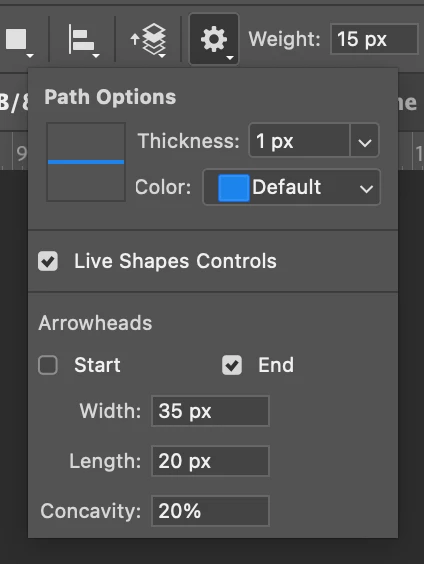

❺ Click on the gear on the options bar to see arrowhead options.
❻ Click on Start and/or End to create an arrowhead at either end of the line.
❼ Set the width, length, and concavity for your arrowhead.

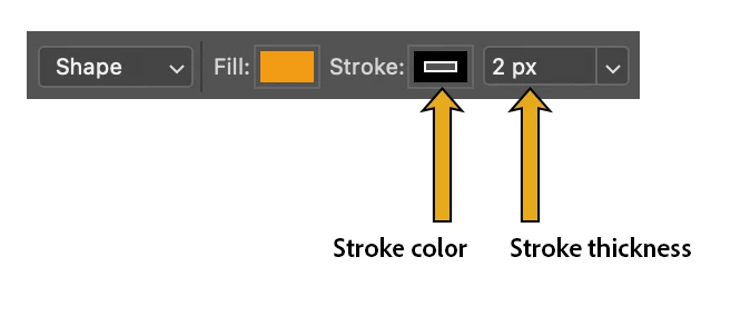

❽ If you want to have an outline around the arrow, You can set the color and thickness of the stroke in the menu bar.

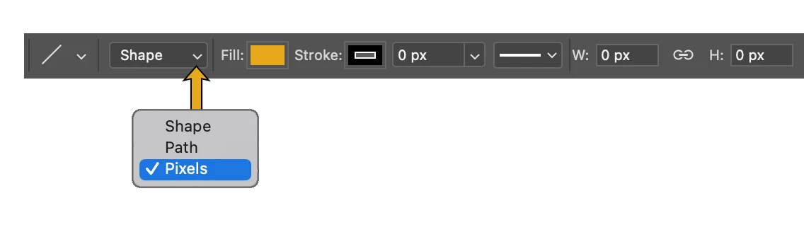

❷ Click on the options pulldown and select Pixel

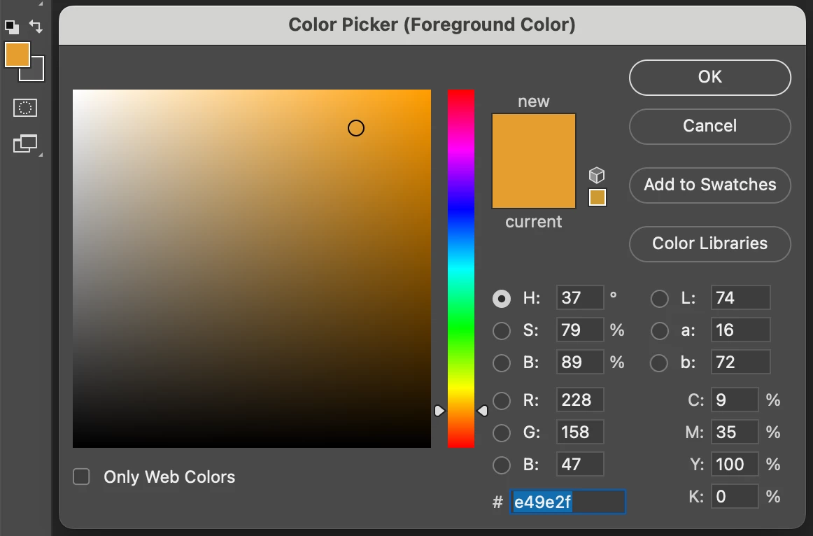

❹ Set the foreground color to the color you want the line to be
